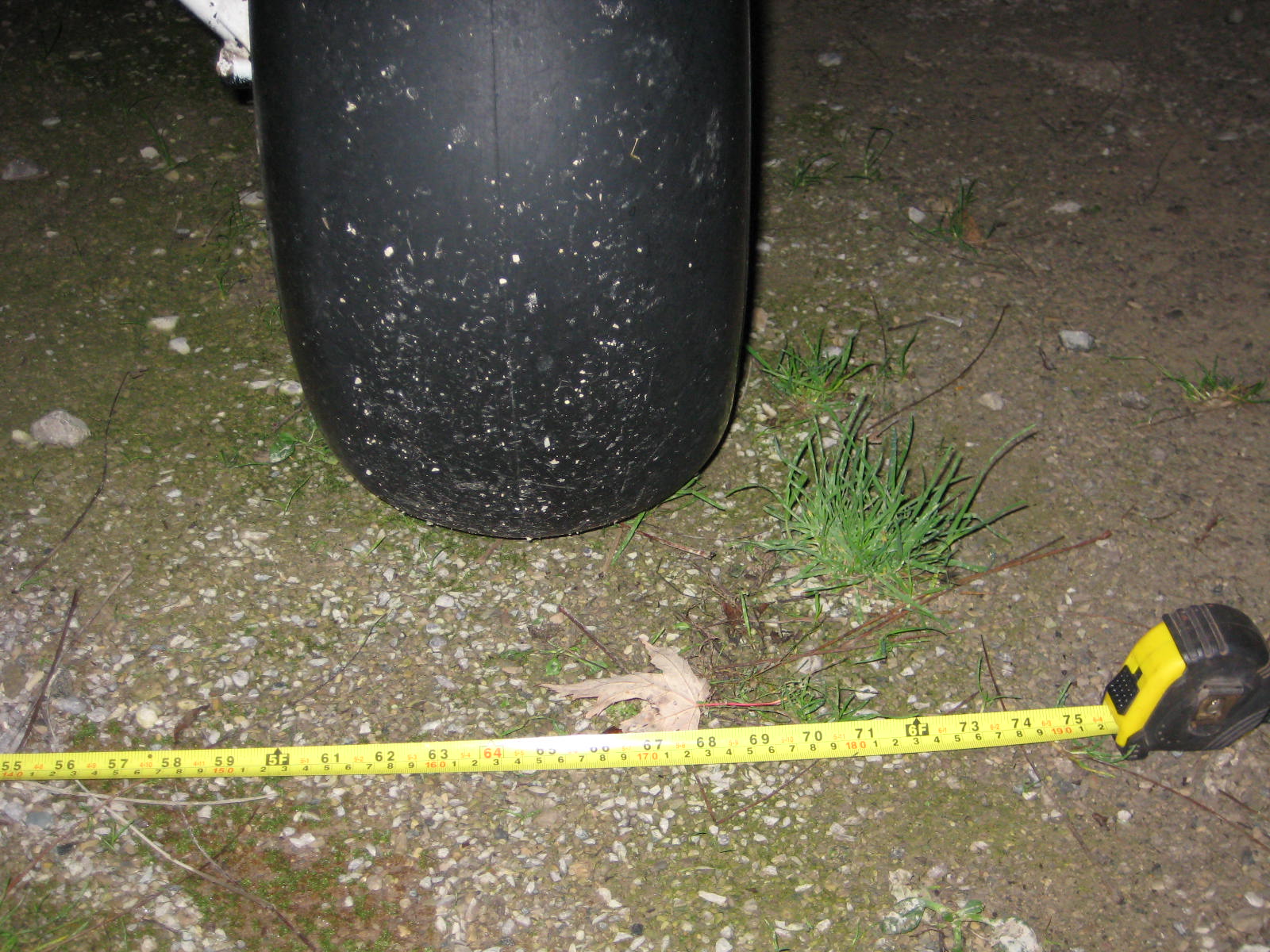

PostPosted: Thu Nov 01, 2007 4:11 am    Post subject: Re: need King Fox rims Reply with quote
I measured mine for you
look like about 70" wide
if you subtract 9" each tire then inside width would be close to 52 "
Dave

PostPosted: Thu Nov 01, 2007 2:27 pm    Post subject: need King Fox rims Reply with quote
thanks Dave this will help me out on the trailer.now I need to clip back
of frame and weld on to outer frame beams to get it a little wider on
each side.and then drop the deck where tire will fit.it still will be
close but I think it will work out fine..the tire look great and all so
the DVD that you sent me.realy cool..I hope and wish that I could B as
good as you are at flying my KF too.great video..and thanks again for
all of your help..Steve Shinabery N554KF,,KF2

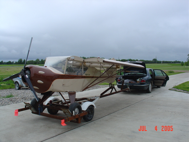

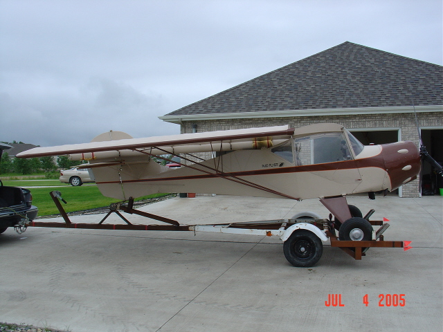

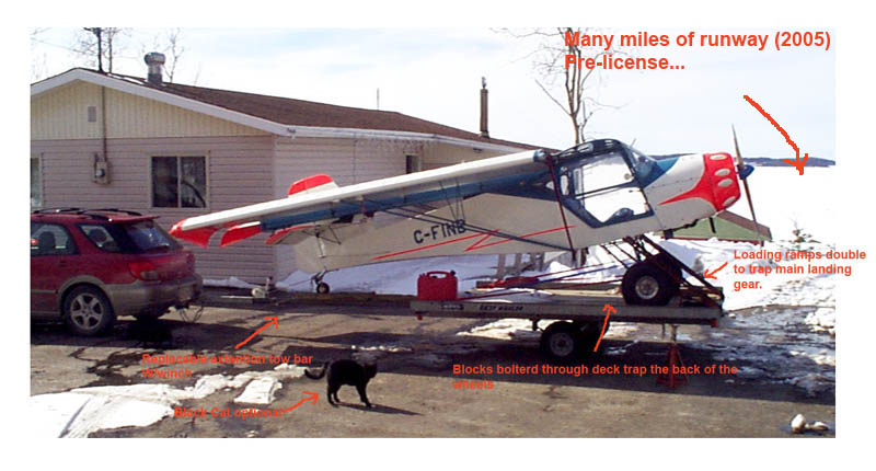

PostPosted: Thu Nov 01, 2007 4:07 pm    Post subject: need King Fox rims Reply with quote
The idea of removing springs sounds Ok to me as long as you leave about 1500lb capacity. You will want some margin of safety between the weight of your plane and the capacity of the trailer.
I found it is much easier to open the wings without installing the turtle deck to load and unload the plane. This made handling the tail much easier. I also have a stand that fits exactly under the nut and bolt for the tail wheel spring. The stand is to keep the plane level when towing. The reason to put the stand under the tail wheel spring mount is to take pressure off the spring itself.
In the following picture I only have the plane on the trailer to take the picture and at that time I hadn't worked out how to guy the tail wheel three ways so it cannot move while travelling.
Notice how the trailer ramps reverse to block the main gear in place. It cannot move left, right forward or back. I expect if I could roll the trailer upside down the plane would not separate from the trailer. Note the straps do not attach to the main gear but only to the loading ramps. In the position the plane is in it would be next to mission impossible to lift the tail up onto the support. with the wings open and the main gear trapped it is actually quite easy to place the support under the tail heed spring attach nut.
The three way guying I mentioned is 1 the main cable from the winch to the tail wheel. this cable will have to be loosened to lift the tail then tightened. 2 and three guys are ratchet straps which attach to the same part of the spring and extend to the rear corners of the platform. I was considering bolting a couple of boxes on the platform to put gasoline in. I don't recommend towing with gas in the wings. Be sure to put some kind of a protection between the vertical stab and the ailerons to protect the stab from abrasion. Also be sure to tie the ailerons together behind the rudder. Don't trust the small supports at the base of the vertical stab to hold the wings in! If they open while towing it will put a dent in your day.
[img]cid:268574723(at)01112007-2DDF[/img]
This is the way I usually tow my plane short distances... only with the wings folded, of course.
[img]cid:268574723(at)01112007-2DE6[/img]

I have a remodeled boat trailer for my Avid Flyers. I didn't build it, it came with the Avid B. Jim Chuk, Avid B 582, Avid Mk IV Jabiru, Chisholm Mn

Noel Loveys wrote:
> --> Kitfox-List message posted by: 'Noel Loveys' <noelloveys(at)yahoo.ca>
> If I were going to build a trailer to carry my plane, I have one now, I
> would make sure the trailer was at least a foot wider than the gear. This
> makes loading the trailer a lot easier ( 6' clearance per side)
> Just an idea.
> My trailer is a double Ski-Doo trailer which I extended the tow arm by about
> five feet using an insert. The insert carries a channel to allow the tail
> wheel to track in while loading and unloading. It also has a small hand
> winch to help haul the mains up on the platform.
> Two good side effects of the extension are the trailer tracks a lot better
> on the highway and backing up is a lot easier. This trailer is rated for
> something in the order of 2500Lb so I can actually carry planes a bit larger
> than my own.
> Noel

I didn't realize the pics would be so small, but I think there is a way to expand them. I meant to mention about how the tailwheel is held in place. There are two hinges welded on on each side of the channel/ramp with staps welded to them. When you flip them up, you can run a bolt through the straps and one of the cross tubes in the fusaloge. This supports the tail so it is not bounceing on the tailwheel spring and ofcourse holds the tail to the trailer. I'm not sure if the Kitfoxes have them, but Avid had two crosstubes in the tailend of the fusaloge that you could hook a hitch to and tow the plane on its own wheels. Jim Chuk Avids, B, MK IV, Minn

Jim_and_Lucy Chuk wrote:
[quote] I didn't realize the pics would be so small, but I think there is a
