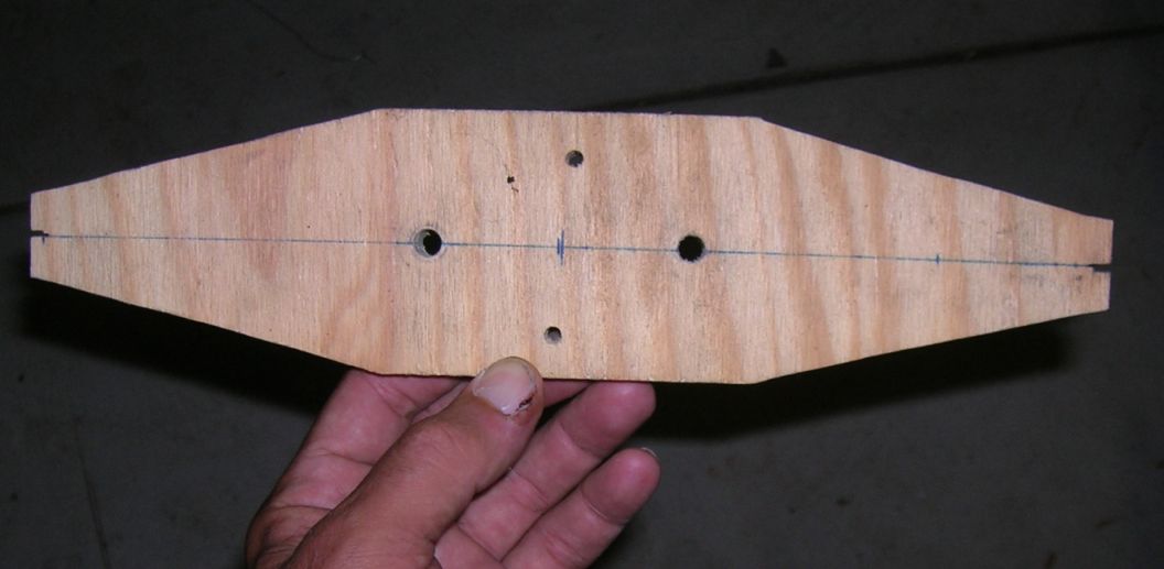

Ladies and gentleman, this test is almost ridiculously easy to do. There is no magic or mystery. The attached photo is of the plate on which I mounted the propellers. The slots in the end are where the 6 foot lengths of safety wire were placed. All told, it took less than 30 minutes to assemble, mount and level the test apparatus. Certainly not rocket science, although I do admit trying to track down the theory of the torsion pendulum to assemble a spreadsheet turned into an exercise in futility.
Fortunately that work was done by Rotax. All you have to supply is the weight of the prop and the time required to swing through 30 oscillations. The only trick to it, I found, was keeping any up and down movement out of the test. Once I got a good side to side swing, I started the stop watch, timed the first 30, then the next 30 and then 30 more oscillations. I also did the test by starting and stopping and starting again, just to make sure that what I learned in physics class about the frequency, speed and swing of a pendulum balancing out was true. Of course there is a small difference due to air resistance, but I couldn't find a meaningful difference in the variance of swing that I used.
It's coming on winter, some of us will lay up for the cold weather, others will be doing maintenance and some are still building. Why not setup the inertia test on your prop and publish the results here. I'll volunteer to assemble the data and publish a table from which some reasonable assumptions might be made by those in the process of considering a new prop purchase.
Rick
