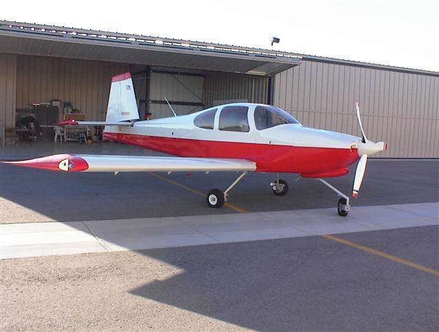

| Quote: | | N991RV first flew on 10/23. 4 hours now but oil temps are too high – 245 – so I’m trying to fix that. Otherwise, it flies great, just as I hoped. What a plane!Albert GardnerYuma, AZ |

Congrats Albert!!
A fine looking machine.
John 40315

Congratulations Albert from Switzerland. Let us know what the reason was for the high oil temps and what you did to get them down.

Very nice Albert! Congratulations!
PJ Seipel
