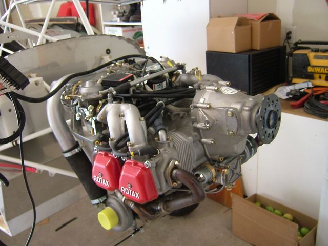

Well, I never thought the day would come but here it is...the 914 arrived on Friday and I had it hung on Saturday. It is a beauty thats for sure! One problem...I was shorted the turbo control unit! When you fork over this kind of cash, you hope that everything is there. I called the company I bought it from and they are working on getting it for me so its not a big problem but it kind of kills the excitement a bit. Now that the engine is hung, I am moving into the electric install and panel so anyone who wants to drop by to help out (electrical systems scare me) is more than welcome.
The Airmaster electric CS prop is also on its way, Hopefully I will be flying come late spring.
For those of you who start to covet or get jealous...keep in mind I have to pay for this and you jealousy will probably leave you fairly quickly. However, the performance is amazing with the 914 so that will make up for it in my mind.
