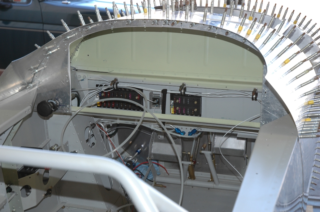

Regarding brake lines: On my RV-8, the way I plumbed
the brake lines was strictly per plans; run the lines
from the brake fitting bracket out to the landing gear
towers along the bottom edge of the rear baggage
compartment bulkhead, and into the middle lightening
hole in the landing gear "towers". From there the
brake lines run down to the bottom of the towers where
they attach to bulkhead elbows that penetrate the
fuselage bottom (inside the gear towers). The
location for this is identified in the plans.
I have attached a picture where you can see left brake
line run inside the fuselage.
