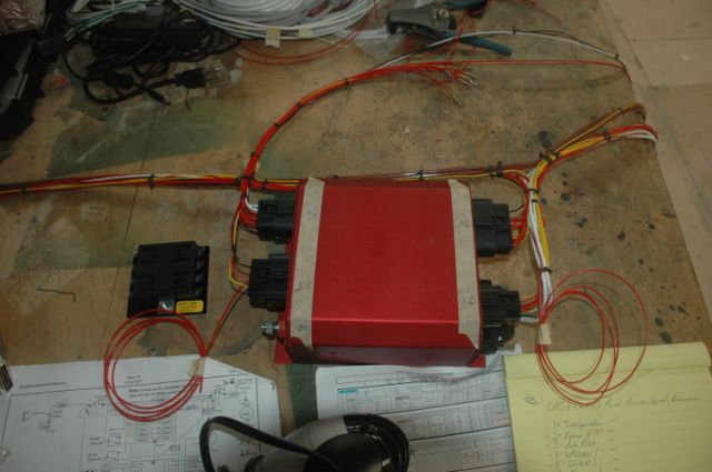

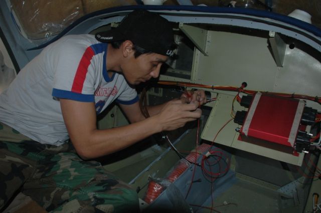

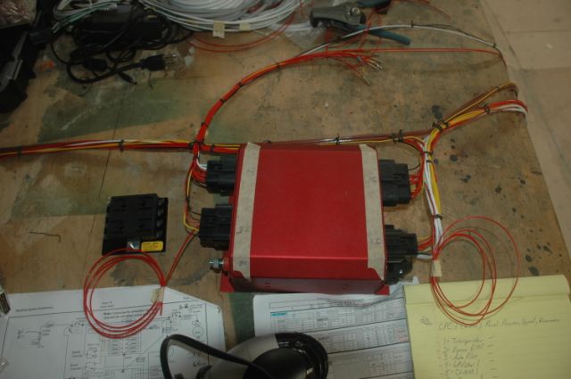

For those who are interested, the Vertical Power system, IMHO, makes wiring the plane a LOT easier and a LOT easier to get your mind around. The load planning worksheet and schematics that VP provides are also very helpful. The ability to do most of your wiring on the bench in a single harness, built around the Control Unit, is really nice. The other wiring harnesses, like Auto Pilot and EFIS and Engine Monitor, can be added to the VP harness on the bench as well. The Radio Stack is easiest to do separately and wire together with the VP through a Connector (there’s that dirty/clean word again).
In short, I really like what I have seen of the wiring benefits of the VP. I will let you know my thoughts on the operating when we get N256H back into the air hopefully next month. It is going to look like a new plane, inside and out, and will have an upgraded panel (although not as upgraded as many started with).
