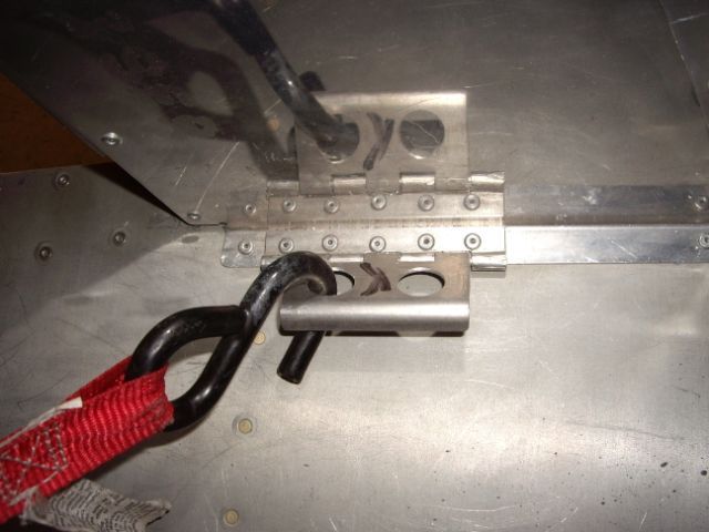

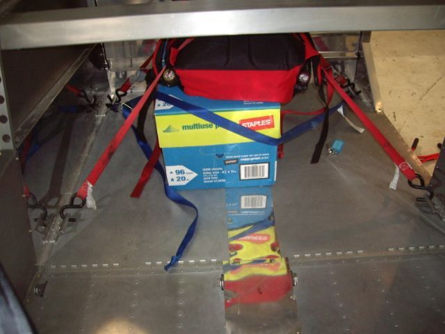

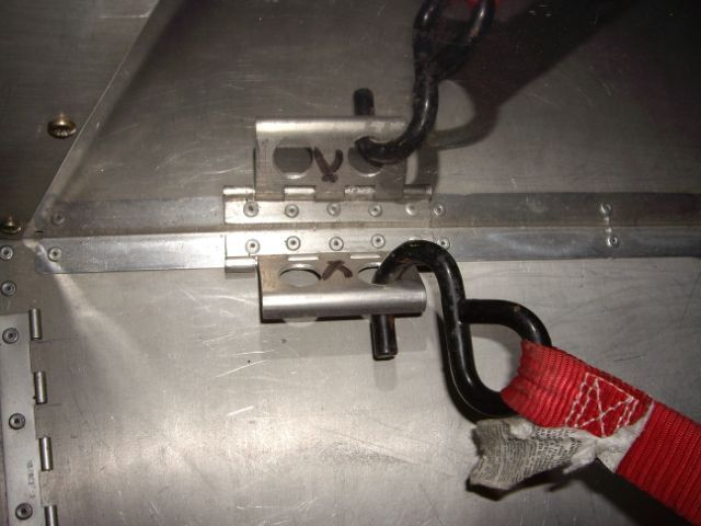

PostPosted: Mon Oct 29, 2007 11:23 am    Post subject: baggage area tie downs Reply with quote
Here are some picture of tiedowns I made out of hinge material. We're getting ready to make these available for sale--they should be on the website in a few days. Price will be $49 for a set of 4. I've had 72# strapped down for all my phase one so far and they're working great. The return on the movable side is to keep it up above carpet level.
Let me know if you need a set. We'll have a couple other RV-10 specific products online soon.
