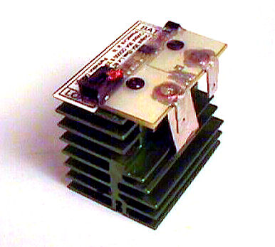

For a couple years I have been selling the 35A "Powerlink Jr." Solid State Relay on my website.
The device is based on an International Rectifier IRF2804 which has a maximum 10V Rds(on) of 0.0023 Ohms.
The device has a hold-on current of 200 microamps, weighs 3.1 ounces, and has it's own heat sink.
http://www.periheliondesign.com/powerlinkjr.htm
 Filesize:  37.71 KB
 Viewed:  777 Time(s)
