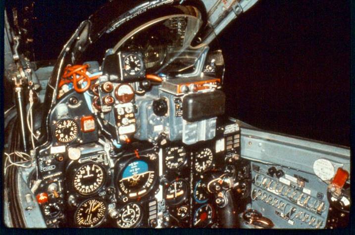

PostPosted: Fri Oct 19, 2007 9:59 am    Post subject: RV8-Instrument Panel Reply with quote
Switch guards might solve the problem of snagging.
Note the attached pix of MiG-21 (right console panel) and MiG-23 second
email due to size of jpg file(to the right of the red marked switch).
Little U shaped guards riveted either side of the switch permit finger
access but generally guard against snagging, as in when climbing in and
out.
Gail Peck
USAF Weapons School
RV-8 Builder (new guy - tail almost done)
 Filesize:  63.16 KB
 Viewed:  1169 Time(s)
