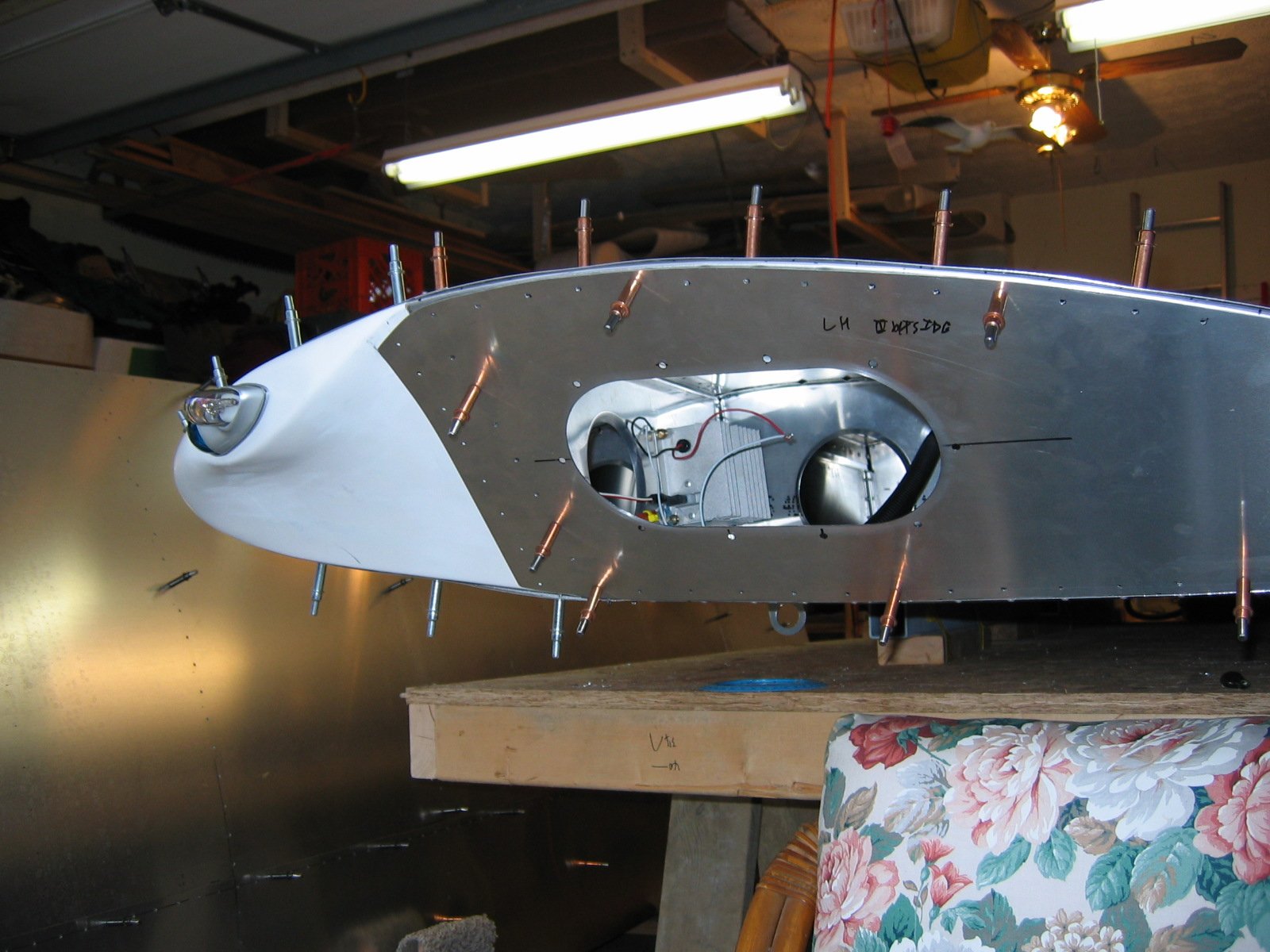

I want to install access panels on the (CH601-HD) wing tip, forward of the spar.
I would like these to be fairly large (diameter of about 25 cm / 10 inches), so I can install and service the strobe later.
I would like to use nut plates and flat had screws, so it has a nice appearance.
Can someone recommend parts (part number, source) and tools for the job?
It seems such a simle thing to make, but I stared at the AS&S catalog last night and couldn't figure which parts / tools to use.
I figure dimpling will be necessary, but have no such tools at this time.
Thanks in advance for any suggestions.

Carlos,
The only supplies you will need are MS21075L3 nut plates, MS20426AD3-2 rivets (2 per nut plate) and a screw AN525-10R7 per nut plate. Tools will be a drill and snips to cut the holes needed. You do not need to dimple the rivet heads if you do not want. I have countersunk mine. You can use a hammer and flat punch to set the rivets if you do not have a rivet gun. Here is a picture of the hole in my XL wing tip showing the strobe pack inside. It also makes a good inspection hole.
Good Luck,
 Filesize:  246.55 KB
 Viewed:  696 Time(s)
David Gallagher
Cincinnati, OH area

Good job and great picture. I do have a question though. Isn't that the wrong color nav light? Left wing should be red I think.
Dan

Well Dan, you got me on that one. In my defense, I only grabbed the closest light to me and used it as the guinea pig on both sides for fit-ups. The lights have not been back in since and await patiently in the box.
One more thing, the hole in the outer panel, as it turns out, is a great grip point for lifting the wing. It has proved to be strong enough to use as a hand hold without distorting. I upped the tip skin piece to .025 (kit is .016).
Good luck,
