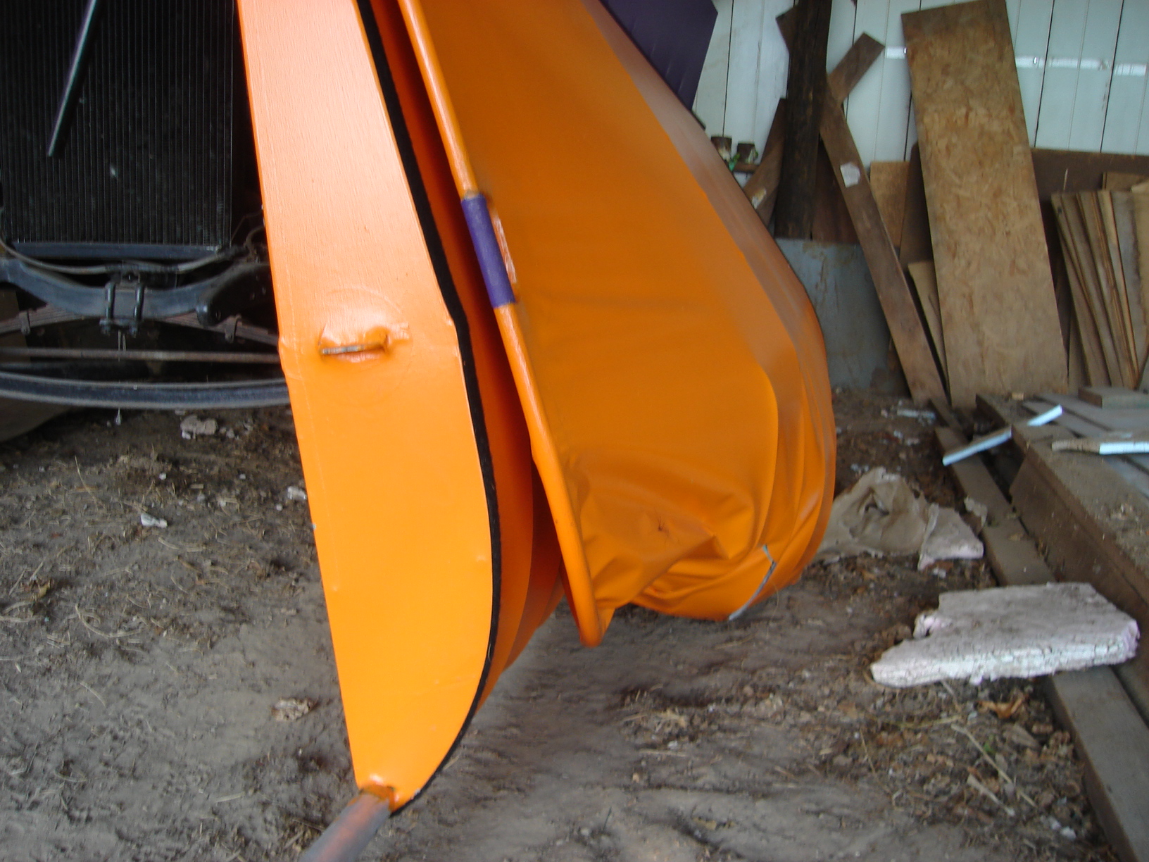

I very much enjoyed your detailed description of calculations and intended remedy for gear leg bending. Please keep us posted on how that works out.
For what its worth, on my recent stall from a few feet into a pothole at Bob Bean's field which broke the left wheel axle fitting and resulted in me ending the landing upside down, the longer than standard 4130 tubing gear legs were not bent in the process. This, even when the leg without the axle fitting dug into the ground as I was still moving forward at about 30 mph.
I've become a believer in heat treated 4130 tubing gear legs. I have no idea if they are heavier or lighter than the stock gear legs, which I know is always important to you for staying under 254#.

John,
I have no idea to what RC the legs were heat treated to because it was done by someone else before I bought it. I only know that it was done or the tubes would have buckled in a heartbeat without the heat treating. They look sort of funny because even with the FS empty, they are slightly bowed and have visually obvious negative camber but no toe-in/out that I can tell. When loaded with me and fuel I'm sure it looks even stranger but they track straight and true and don't bounce much at all with imperfect touchdown. I expect that with much use on paved runways, where I'm located, the inside sides of the tires will wear first, then I'll turn them around and wear out the other side.
Great gear legs is all I can say. If my pothole landing did not result in damaged sockets it is unlikely I'll ever have that problem, without breaking a lot more too.
Almost done with the wingtip structural repair. Boom tube is next.

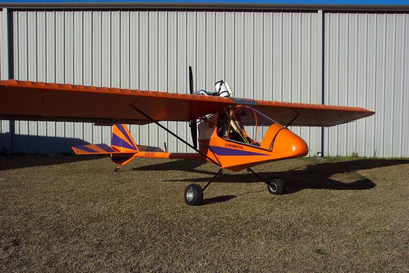

PostPosted: Mon Oct 08, 2007 5:37 pm    Post subject: FireFly Landing Gear Leg Strength Improvement Reply with quote
Thom in Buffalo
Thom:
The 4130 legs can be pressed straight or a little past straight to give you
some positive camber. Not only does it look much better, but when loaded up
from landing forces, the positive camber will get pulled toward neutral
camber and load everthing more evenly.
Negative camber makes the airplane look like it just finished making a hard
landing.
you
Gang:
Forgot to add something to the last.
Not a good idea to try flying with 4130 gear legs that have not been heat
treated. Prior to heat treating they will be extremely stiff, and bend
permanently if stressed to much.
After heat treating the legs become very springy, because they are springs.
At 48 RC they make a good spring, but when pushed over the limit, they will
bend before they break. I do not know where that RC number is that will
make them brittle. I have had great luck with 48 RC.

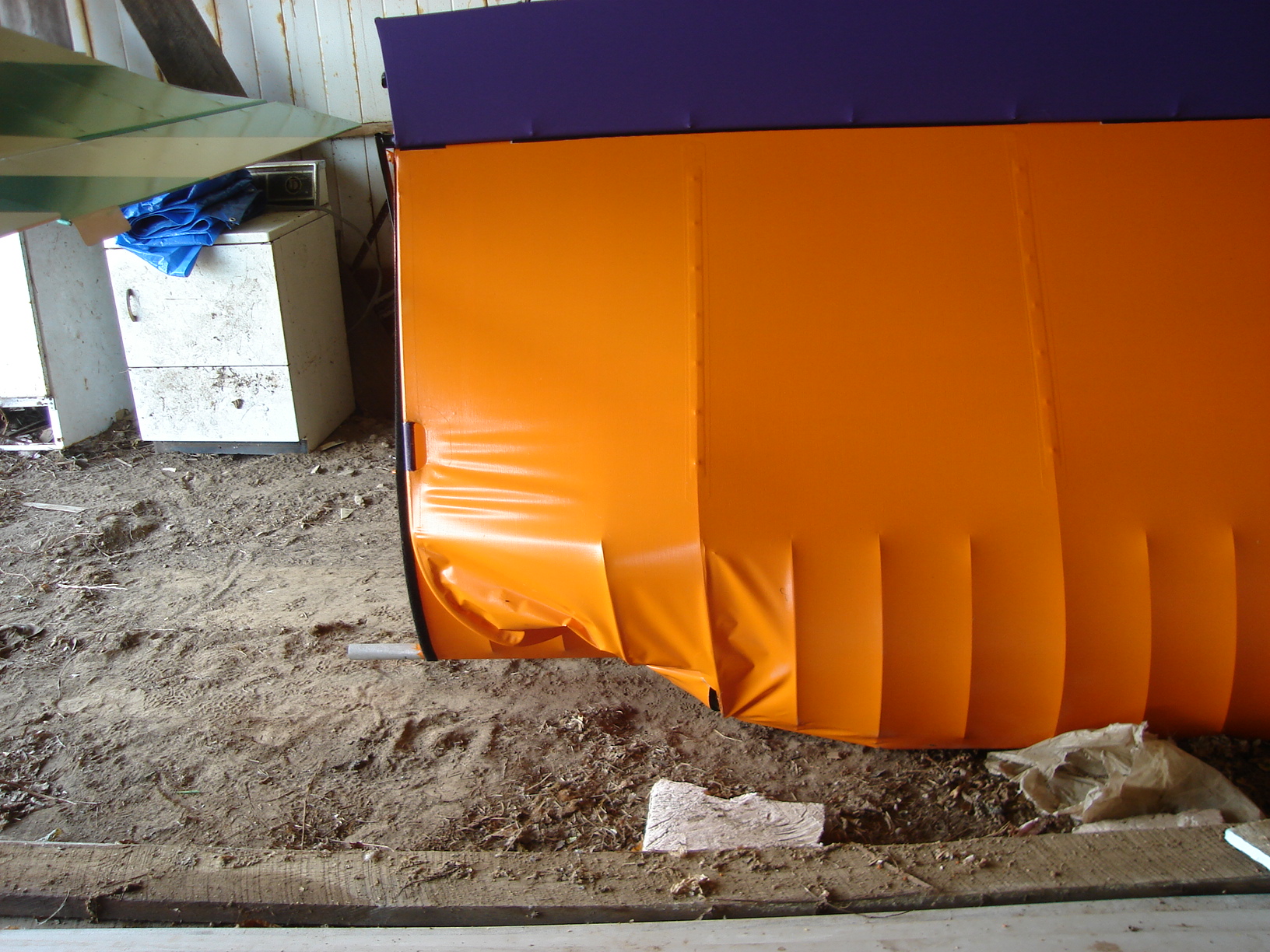

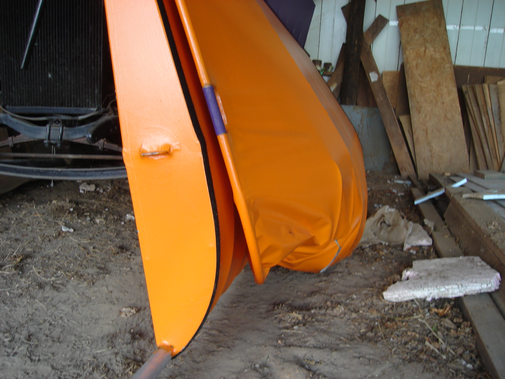

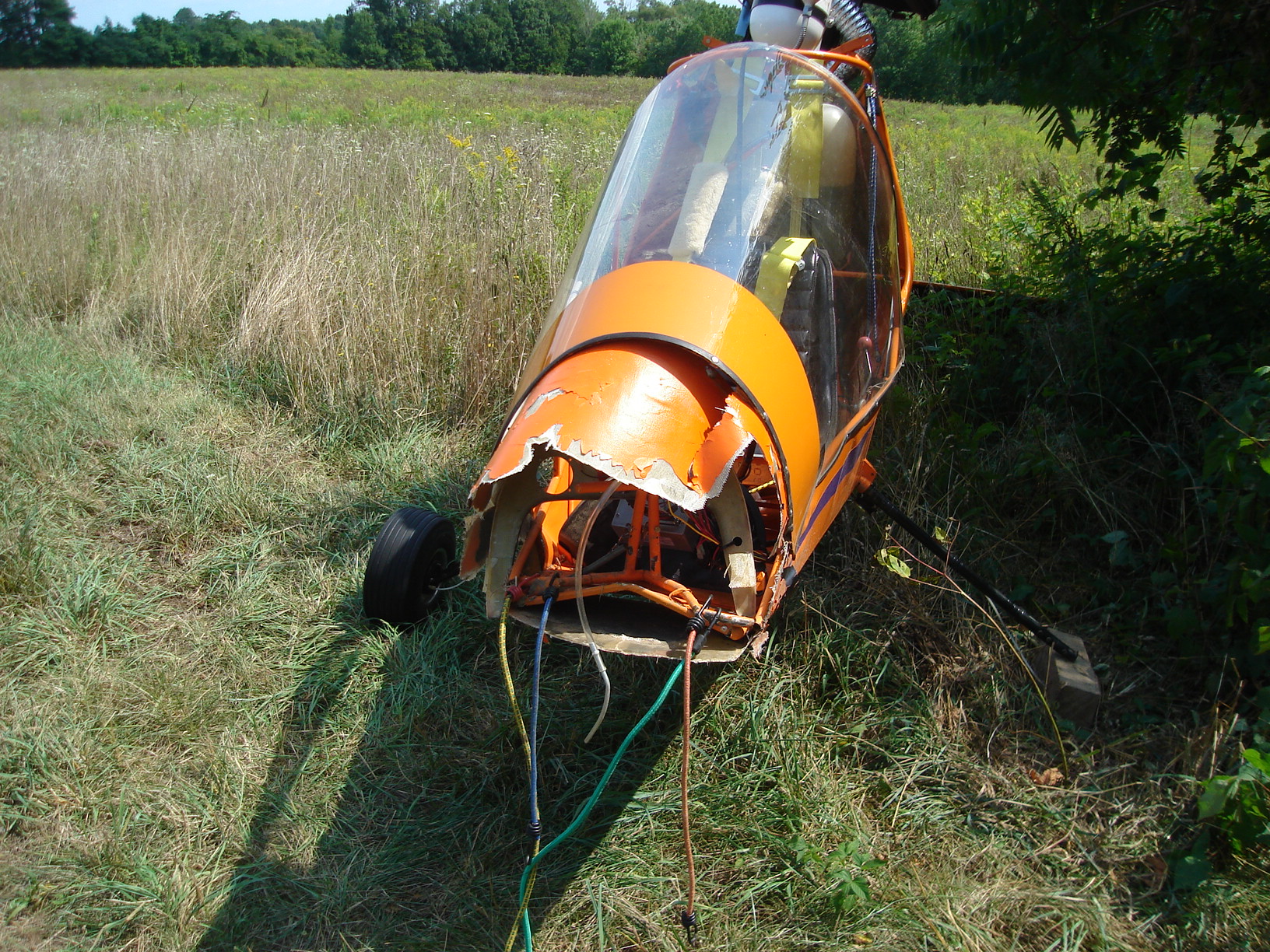

Along with the relatively minor wing tip damage, the nose cone was destroyed and the front of the cage was bent as was the left upper longeron, one wing strut bowed, the sacrifical PowerFin prop was destroyed (blades only) and the boom tube broke just aft of the H-truss. Bob Bean repaired the cage before I removed the remains from his place where the incident occurred. The engine is fine and the empenage was untouched.
John,
Thanks for the pointers about pre-stressing the 4130 tubes to remove the static negative camber. Once I get the FS flying again next spring, I'll see about fixing that. It DOES look strange.
Thom Riddle

John,
Yes it is a FS1 w/ 5 rib wing.
When you start listing the damage it sounds worse than it was. One wing received no damage at all nor did the tail. Yes it is a good bit of work to fix but nothing like building from scratch. The only bodily damage to me was very bloody shins from the instrument panel trying to occupy the space reserved for my legs. All healed now.
Thom Riddle

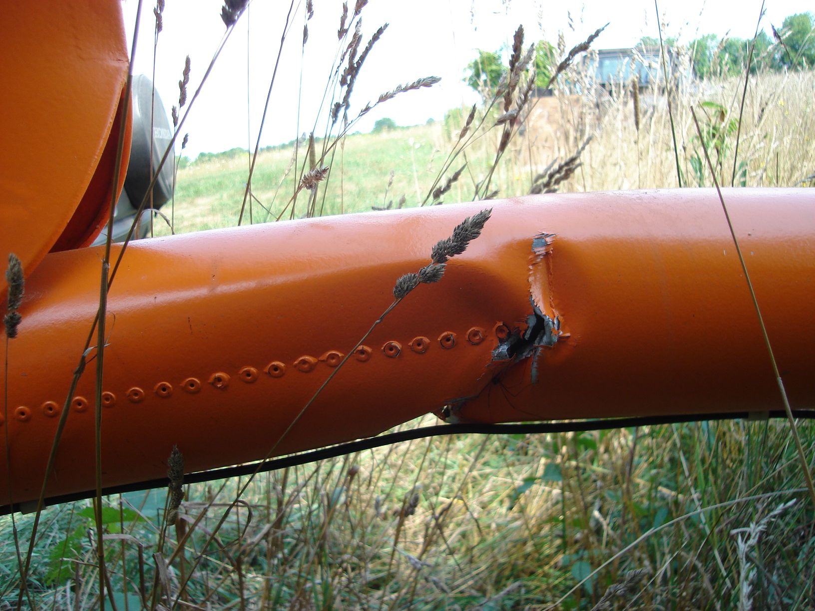

I have to disagree with you.
The damage you describe indicates the FS took some tremendous hits. The
tailboom does not snap unless there was another action that caused it. Did
the tailboom fail laterally or vertically?
If it failed laterally toward the tip of the wing that took the hit, I have
no idea how much stress was placed on the wing prior to the tailboom
failing.

Picture this, if you can:

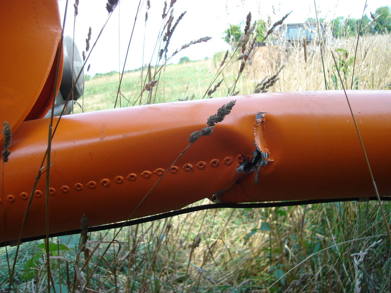

You have a long stick with heavy weights on each end (boom tube with empenage on one end and cage etc. on other end). Somewhere sort of near the middle of the stick you have two smaller sticks(gear legs) attached to it that extend downwards as the stick is falling (more or less horizontally). Remember I stalled 2-3 feet above the ground. The two sticks attached to the big stick hits the ground first and the momentum of the heavy weights on each end want to keep going when the short sticks stop dropping downward. The result is a tremendous bending moment in the middle of the big stick. One of the photos shows where the big stick gave up the effort to resist the bending moment.... at the aft end of the H-truss.
The wing tip damage was confined to the outer most full rib, the stabilizing tubes going from the end of the main spar and the wing tip bow, the two most outbard false ribs, the wing tip bow and about two feet of the leading edge tube. All of the full ribs have the aluminum angle braces at the upper and lower camber going from the main spar to the leading edge tube. The new full rib I bought from Travis did not come with the angles but I'm adding them to the replaced full rib. I thought they would have come with the rib but they did not.
I've already done prop flange run-out check and closely examined the gearbox for cracks and it is clean. No damage to the engine nor the tail nor the left wing except for a slight bow in the left wing strut, which will be replaced.
Any more thoughts on this you might have will be welcome.
H-truss.
Thom in Buffalo
Thom:
Looks like you have it all figured out.
Let me be blunt, if I may.
Based on what little experience I have crashing Kolbs, your crash rates
right up there with a hard, very serious crash. You are lucky you walked
away with only bruised shins.
Your idea of how the airplane is set up is somewhat askew from mine. The
tailboom butts up against the gear leg sockets into a steel ring that is
welded to them. The legs are inside these sockets. They are at the forward
end, not in the middle. The center of the H brace is about (WAG) 1/4 to 1/3
of the boom from the forward end.
The tailsection is not that heavy, acts to dampen some of the inertia during
a crash as it moves through the air laterally.
From the looks of the right wing tip, that is what stopped the forward
motion, in conjunction with the nose of the fuselage. This is based on
damage I see in your photos. If the gear legs and/or their sockets did not
fail rearward in the crash, it was because the airplane was on its nose and
right wing tip. The gear legs probably did not dig in. When the legs made
contact with the ground, the tail came up and the nose and right wing tip
contacted and stuck in the ground. I am familiar with the terrain at Bob's
airstrip. I think the soil and sod would be perfect to stop a good crash.
Wink That wing tip is 12+ feet from the fuselage, a very long lever. The
photo indicates the nose and the wing tip stopped suddenly. Even though you
were only a couple feet in the air, as you say, I think you had already
stalled the aircraft higher and did not realize it. This is a very common
experience for Kolb pilots, even though they may be very experienced
aviators. The other major component was your forward speed, coupled with
your vertical speed, resulting in a very hard crash.
My thoughts and experience only, for what it is worth.
Personally, I would not fly this airplane until I had pulled the fabric and
gone through both wings, not only to insure integrity of standard
components, but to also beef up lateral bracing of the leading edge. Those
rib bays are very big. At the center of the rib bay the leading edge is
drilled top and bottom for a false rib that adds no significant strength to
the wing. If anything, it tends to set up this point for failure. The
drilled leading edge is also .028", which is weakened by the drilling. The
center of the rib bay between the 2d and 3d rib from the outboard end is the
weakest point of the wing. That is exactly where the failure of both my
right and left wing was initiated.
I won't try to tell you what to do, but wanted to share my experience and
thoughts with you. I have personally experienced the demise of all three of
my airplanes, more than once, while sitting in the pilot's seat. Not
bragging. Trying to prevent someone else from duplicating my mistakes.
Take care,
