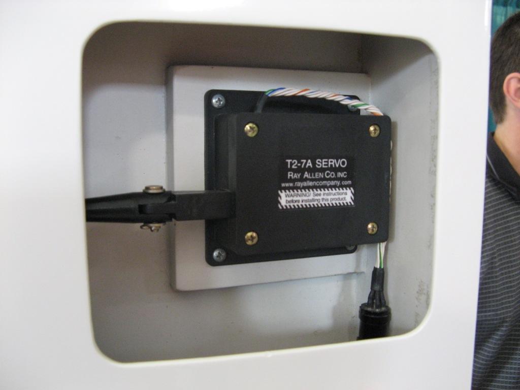

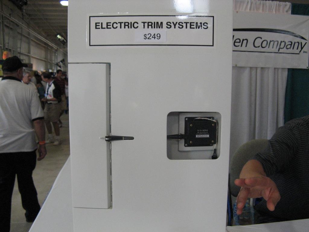

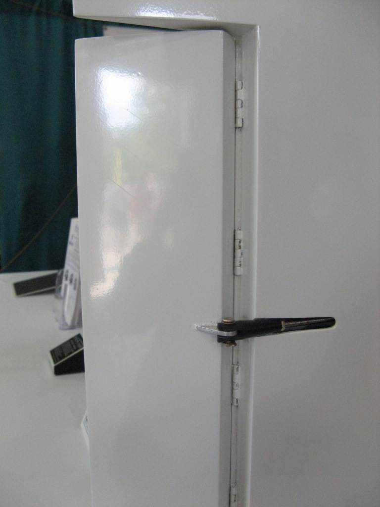

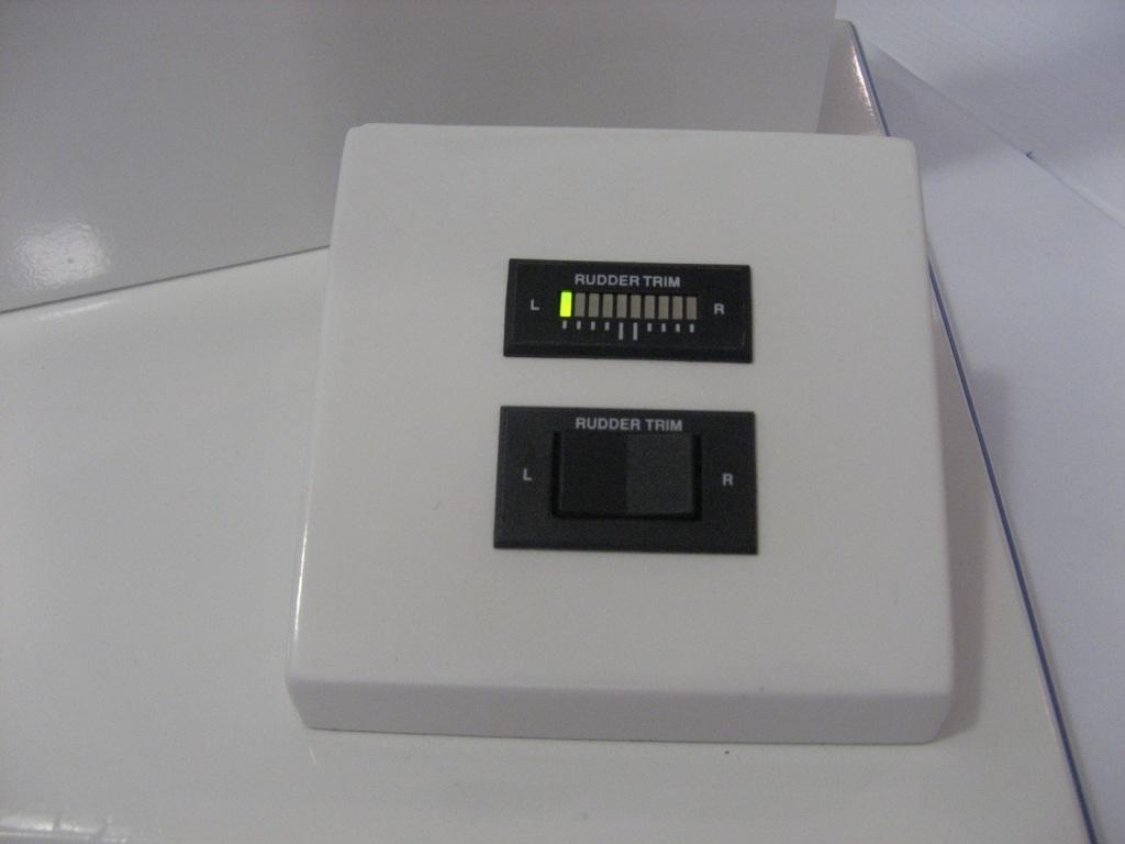

I am also interested, but haven't done anything yet. I did take the attached pictures of the Ray Allen display while at Oshkosh this summer. Hope they help.
