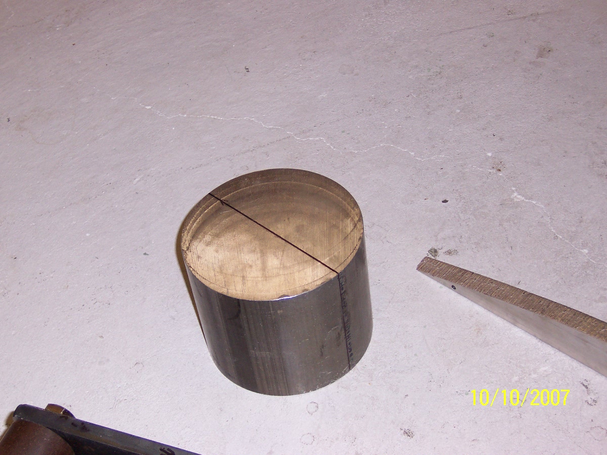

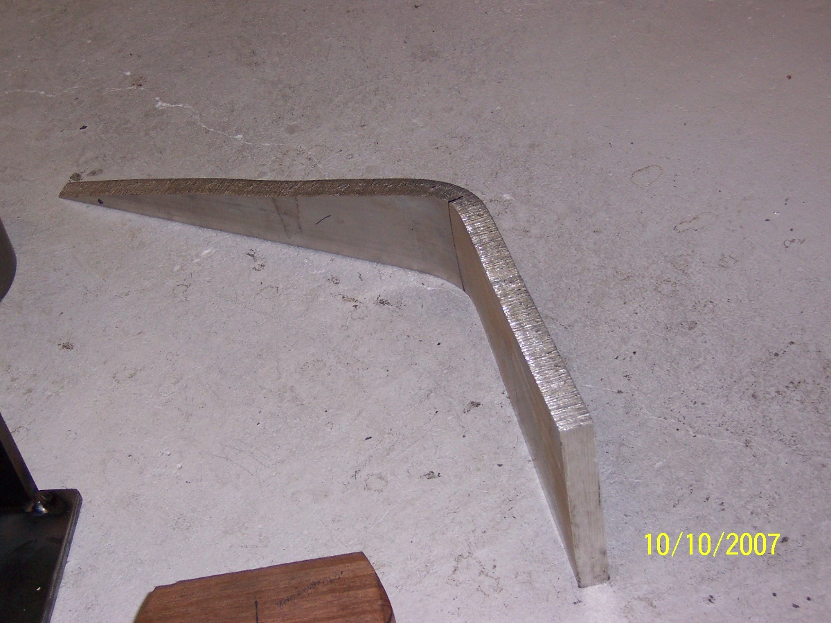

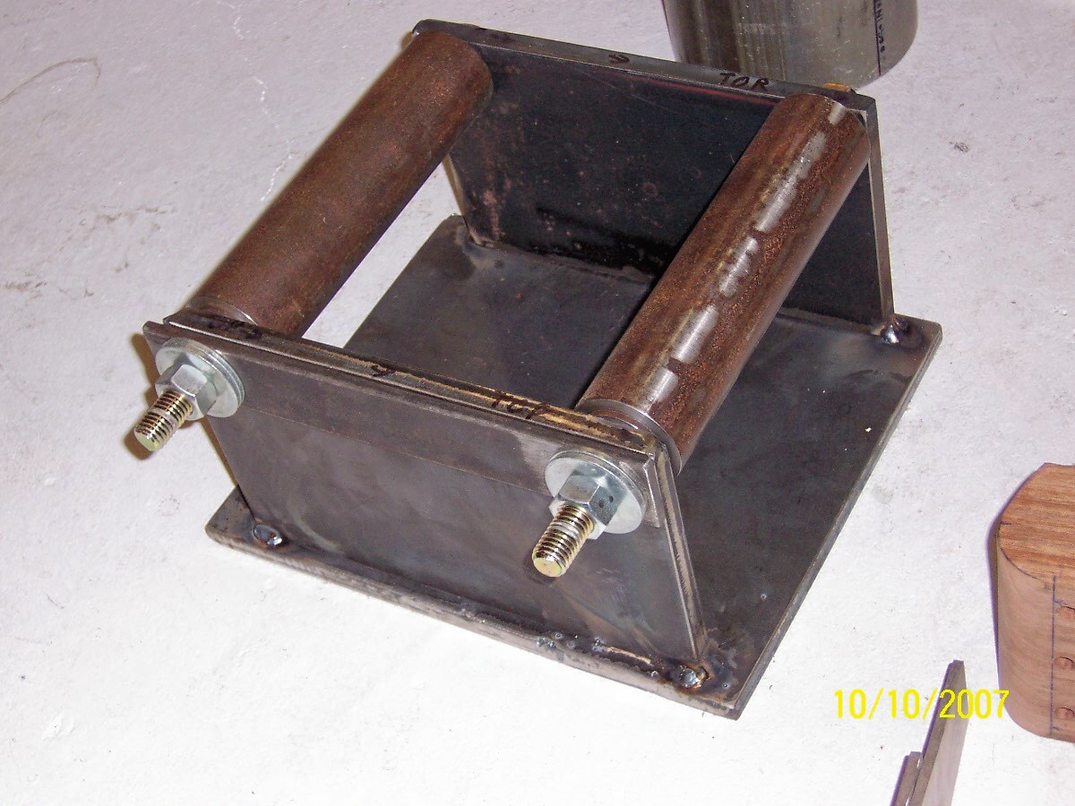

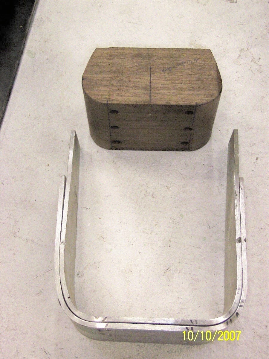

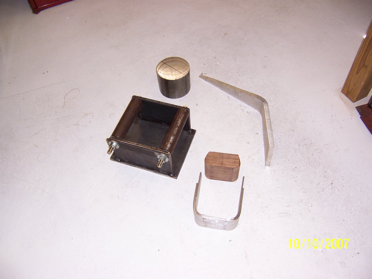

tigermiller
Joined: 09 May 2007 Posts: 11 Location: Omaha, NE
Posted: Thu Oct 11, 2007 7:59 am Post subject: Re: Bending the main gear (and the nose gear fork) |
I've sent a write up and pictures to the matronics photoshare thingy. I guess you have to wait awhile for it to get to the fileshare/photoshare
facility. I've also sent it to Mark up at the ch601.org web site. I'll also attach all of it to this note. If you can't find it, send me a note and I'll e-mail you what I have.
Dave

sky_ranger161
Joined: 07 Jun 2006 Posts: 91
Posted: Thu Oct 11, 2007 11:20 am Post subject: Bending the main gear (and the nose gear fork) |
Wow Dave!
Your write-up and pics are exactly what I was looking for. Very ingenious. Thanks for posting them here, and at the 601 site. Posts like yours are one of the reasons I still stay on this list. Thanks again for willingly sharing your set-up.
