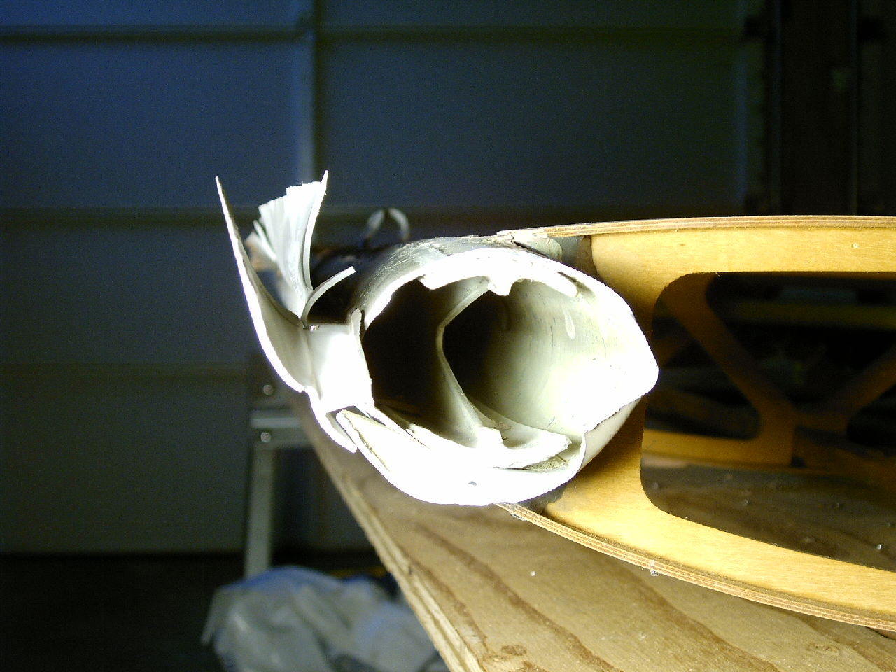

My wife and I sloshed the spar interiors after the ribs had been installed by pouring 8 oz. of thinned epoxy chromate primer into each spar and capping the ends with old tennis balls pressed in. Total paint used was less then a pint. The attached photo shows the interior of one of the spars which was broken in an accident. Note the primer covering the spar. Prior to sloshing we cleaned with metal prep and alodined.
Interior of spar at reinforcement after sloshing with epoxy primer
 Filesize:  450 KB
 Viewed:  614 Time(s)
Joel Mapes Kitfox 5 912 ULS Aerocomp amphibs

Thanks--the picture looks good. Leon Morris/Classic 4/60%/Flower Mound,TX
