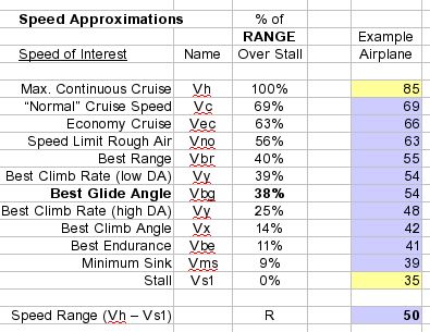

On April 5, 2007 I posted a spreadsheet showing the approximate relationship among the V-speeds on light aircraft. If you have spreadsheet software you can view it and use it.
If you don't you can get a good estimate of the Vx speed for your airplane if you know the clean stall speed (Vs1) and max continuous cruise speed (Vh). Subtract the stall speed from the max. continuous stall speed and multiply that number by 14% and add it back to the stall speed.
Example:
Vh = 85 mph
Vs1 = 35 mph
Vh - Vs1 = 85 - 35 = 50
50 x 14% = 7
7 + 35 = 42
42 mph would be a good estimate for Vx for this airplane.
Thom Riddle
Buffalo, NY (9G0)
- Anonymous
Thom Riddle
Posts: 1597
PostPosted: Thu Oct 18, 2007 5:25 am    Post subject: Re: VX Reply with quote
While I'm at it I figure it wouldn't hurt to attach a jpg image of the approximate v-speed relationships to Vh and Vs1. See attached image and use following formula for approximate V-speed of interest.
R = Vh - Vs1
where
R = speed range
Vh = max. continuous airspeed
Vs1 = stall speed without flaps
General formula or approximate V-speeds:
R x %(V speed of interest) + Vs1 = approximate V speed of interest

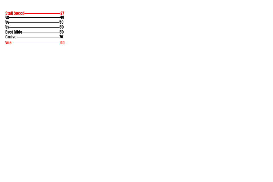

Here's what mine is....(See Attachment)
it's NOT exact.....But it's what "I'm" comfortable with.

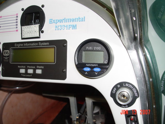

You can see in this picture , That the computer "print out" was taped onto the panel....
(Til something is engraved)
