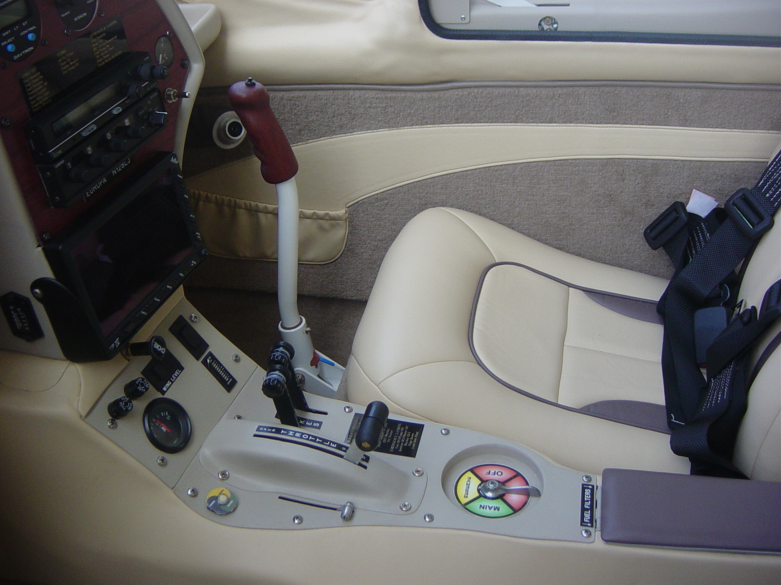

We cut this console down but added several layers of bid to reinforce
the inside. We then created the top with 5 layers of bid. It's secured
with #10 screws and nut plates. The left seat was widened by reshapeing
the left side of the console to allow for more leg room. This was done
with 3 layers of bid over a center of 1/4 inch foam shaped to allow a
right leg more room. As you can see it makes a great arm rest and a lot
more room for toys. The fuel filters are located right under the arm
rest and can be viewed in flight anytime.

fklein(at)orcasonline.com
PostPosted: Mon Oct 08, 2007 1:27 am    Post subject: centre console Reply with quote
reshapeing the left side of the console to allow for more leg room.
This was done with 3 layers of bid over a center of 1/4 inch foam
shaped to allow a right leg more room. As you can see it makes a great
arm rest and a lot more room for toys. The fuel filters are located
right under the arm rest and can be viewed in flight anytime.
Jeff...what an absolutely elegant mod...I salute you. I take it all
this was done prior to CM installation...(?)
Fred

jeff(at)rmmm.net
PostPosted: Mon Oct 08, 2007 6:35 am    Post subject: centre console Reply with quote
Yes,
This was all done before, but I cannot take total credit for it. There
we're several done this way at Flight Crafters in Florida. I just took
it to the next level by increasing the leg room at the side of the CM.
Now if I could just get all the cylinders to run at closer temps I
would be happy. Still working on that though. Looks like I'm going to
need to by the baffling that was supposed to be supplied with the
firewall forward kit that I never received. I believe I have run out of
other options. The engine is cooling but not evenly. If anyone out
there has a picture of one please post it. Maybe I can make it.
Jeff R.

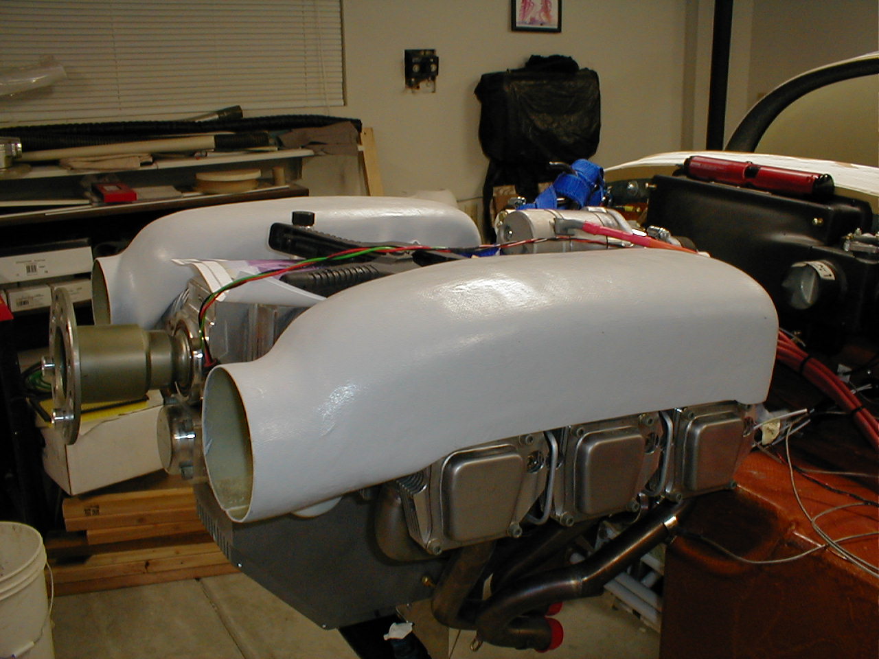

DuaneFamly(at)aol.com
PostPosted: Mon Oct 08, 2007 4:34 pm    Post subject: centre console Reply with quote
This is what I got with my Jabiru 3300A. If you would like pix of just the cowls....let me know off-list and I'll take pix and send them to you.
Mike Duane A207A
