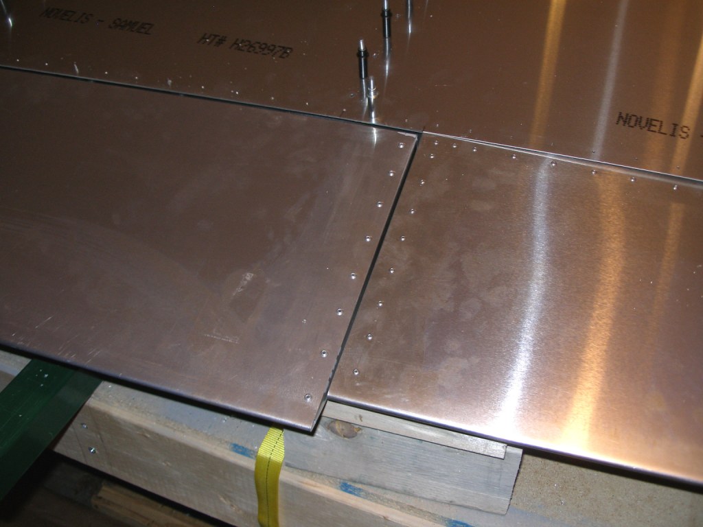

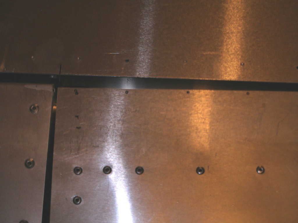

Actually, I did follow the plans and specs very carefully. It turns out that the skins were not drilled correctly. See photos. The first one shows the alignment if I were to get the proper edge distance on the aileron skin. The second shows dots where the rivet holes in the aileron skin would have to be if I aligned the trailing edge with the flap. At the tip, I could get the proper overlap, but I suspect that "skewed" the aileron, somewhat. Therefore, I went with the "real" hinges.
Jay in Dallas 601XL N2630J

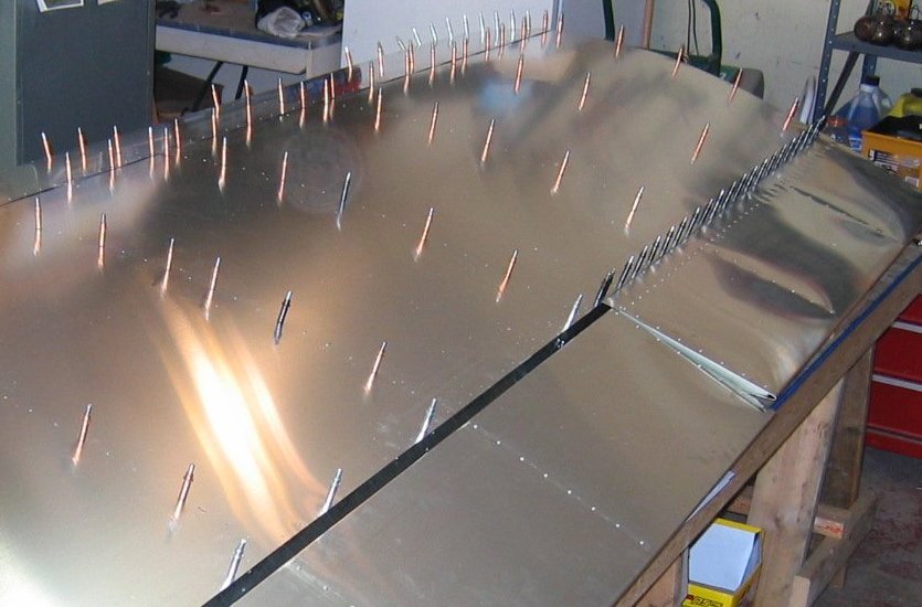

Although it is not a good viewpoint, here is a picture of mine. I have about 3-4mm of trailing edge difference when the aileron and flap are lined up. The aileron is the one that is a little short. In order to preserve the aileron rivet line edge distance I left it that way and pressed on.
Good luck,
