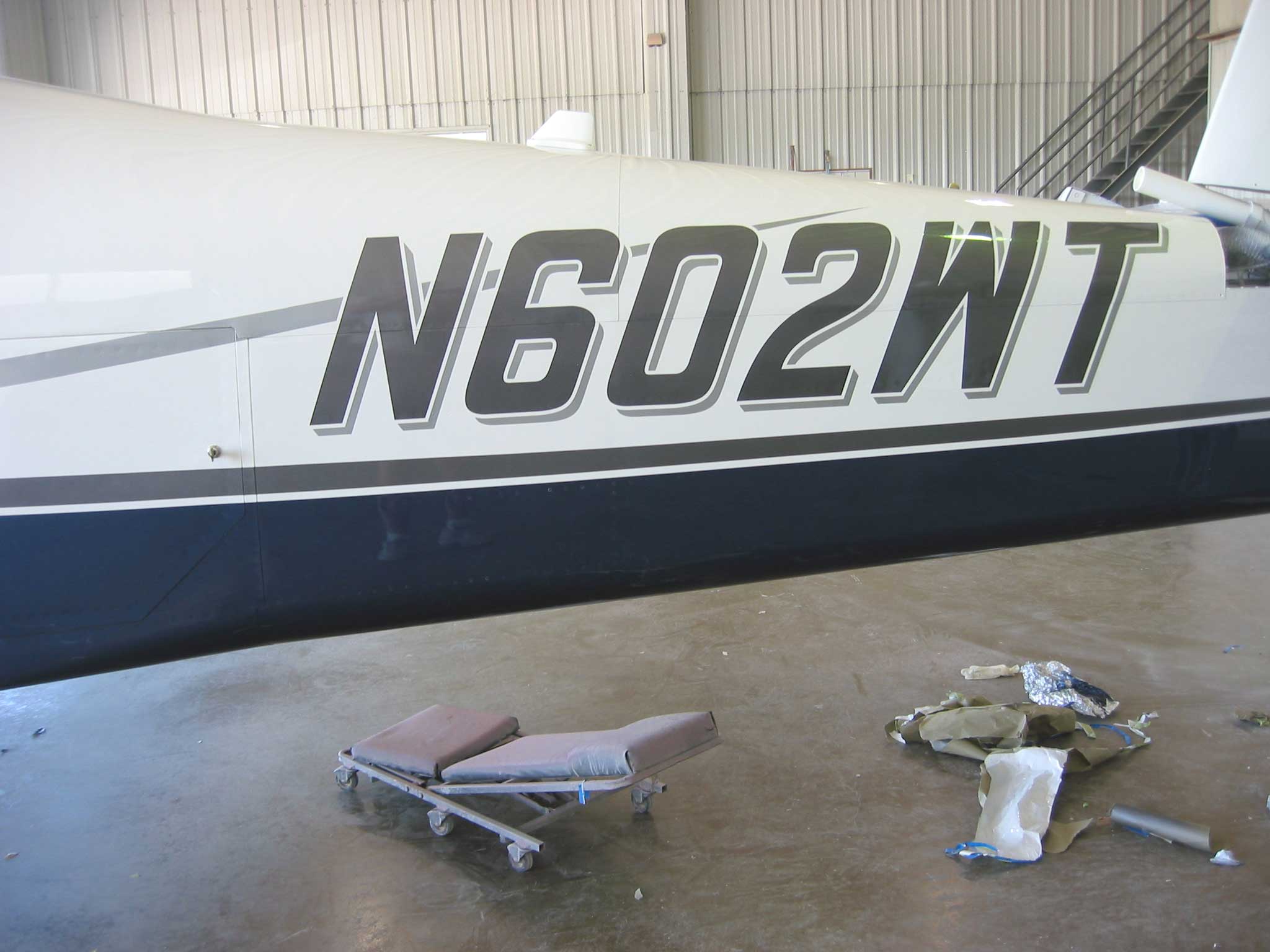

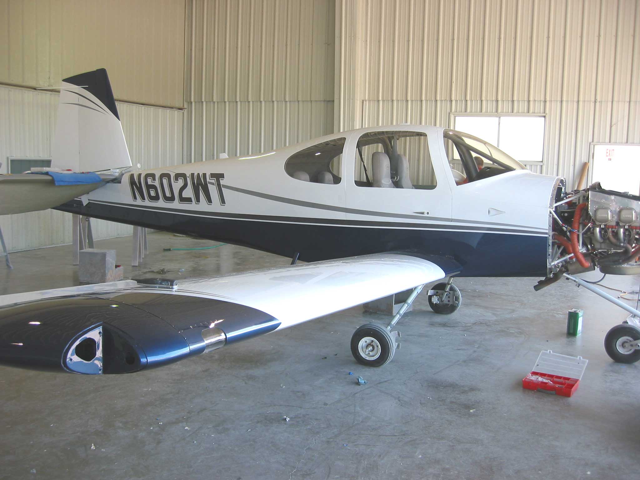

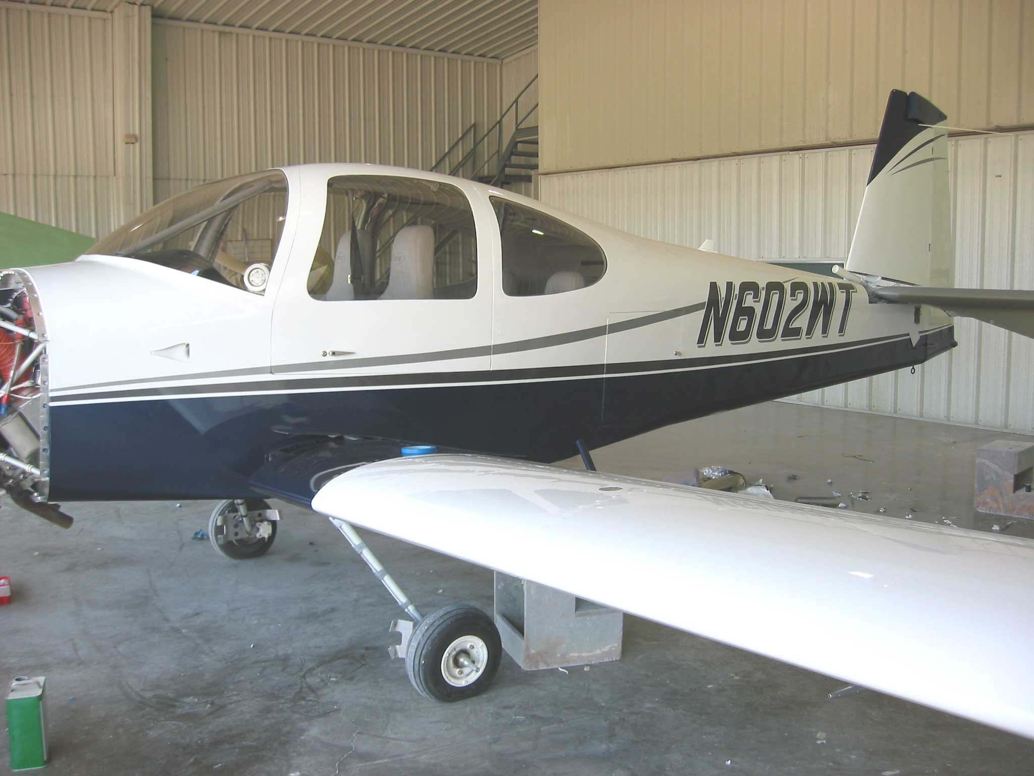

Have any of you made or found interior sun scrrens for the 10 for when it's setting out on the ramp? I'm planning on flying over to LOE and just got to thinking that I don't have any of these yet.
Wayne Edgerton N602Wt
Coming out of paint shop on Manday I've attached a couple of previw pictures fo the progress thus far.

Wow, the plane looks great!!!

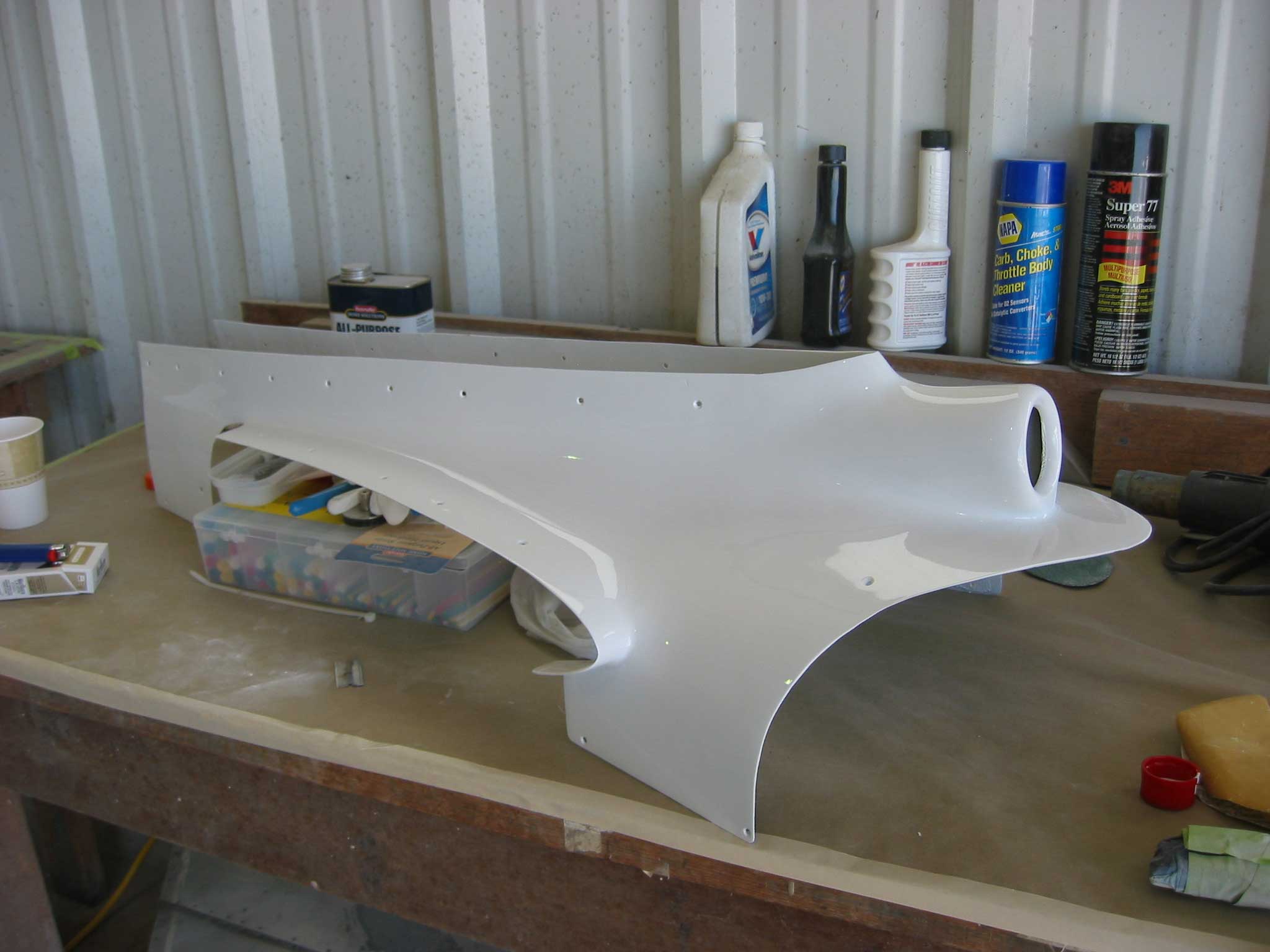

I was wondering this too and had asked Wayne about this this morning. He installed his before the NACA option came up but he is getting good airflow through the scoop.
Is anyone here flying with the NACA vents for the Accuracy overhead console instead of the emp fairing scoop?

There is someone flying with the dual NACA vents, he's based out of Watsonville CA and Bill Derouchey know home, he put me incontact with him and he reported plenty of air even diring taxi with the NACA vents, sorry I don't remember his name and I'm away from home for a few days.

I also spoke with the Watsonville owner before making my decision to go with the NACA vents. He informed me that there was plenty of air flow thru the overhead even during taxi and that if he had it to do over again he would blank out the rear PAX side vents because the air flow is so good with the NACA vents. I chose to leave them in to provide an assortment of places to ventilate.
My question to him was; do I need 2 NACA vents? There was no definitive answer to that question and so I took that as a sign to put two in because I know I didn’t want to retrofit the second one in at a later date.
Patrick, the one probably obvious benefit to the NACA vents even if they don’t provide as much airflow to the console (I suspect they provide a lot more) is their simplicity of installation and no need to build in a water drain system as the air flow and tubing all work their way up. The rear scoop will collect water and must be accounted for.
Robin

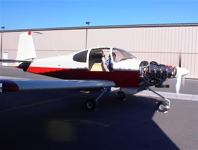

I put in NACA scoops on each side for the overhead console. Works good on
taxi but not flying yet. Plenty air.
