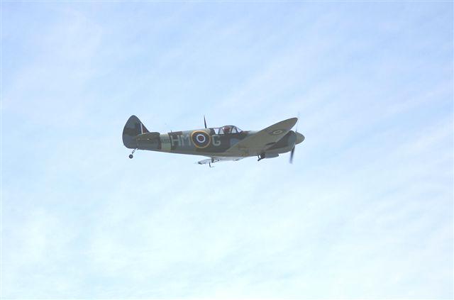

PostPosted: Sun Oct 14, 2007 5:04 am    Post subject: New to LOM Reply with quote
Robert,
For my files and just in case, would you send me the email addr of Petr Prokop please.
The LOM in the Spitfire is running well but for ocassionally dropping a plug in start-up/run-up. Fortunately I put a cylinder temp probe on all six so can pin it down quickly.
I wonder, to all on this chat, with the "shower of sparks" device, is it necessary to have the plug gaps so small? Could I help the above problem with wider plug gaps, say 22 thou? Any other sugestions?
Dave Austin 601HDS - 912, Spitfire Mk VIII
