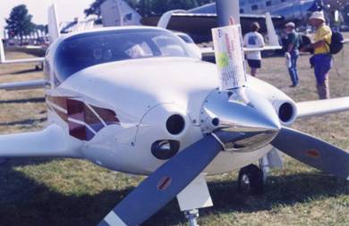

I've had a chance to test my turbulators installed at the mouth of my
left cooling intake and they worked exceedingly well. I've seen, on
average, a 25F drop in CHT's on the left side now that I have
turbulated the airflow entering the left side intake. One cylinder
dropped 45F and went from being the second hottest of the six to the
coolest. Interestingly, the engine is now running in the 240F-260F
range on all CHT's, but the delta pressure did not change!
Clearly, Andy Silvester used the Lancair cowls as a model for his
Europa cowl set. I've studied close up pictures of the Lancair cowl to
try and find out what the difference between the two really is. The
only thing I notice is the Lancair inlets protrude about 1" farther in
front of the cowl than mine do.,  I think this has something to do
with the pressure wave I've observed in front of my left intake with
my crude string tests. So Gilles, you are likley correct in your
analysis.

thanks for your fascinating test results. I too am very puzzled by the
apparent lack of effectiveness of Pressure. Air will only move from hi P
to Low P, (apart from Coriolis effects of course, witness circulation
round cyclones)
I wonder if your turbulator is helping keep the flow attached over the
whole of the outside of the cowl? That might reduce the pressure around
the outlet at the back and that is what is important as we all know but
can't quite understand (how to make it better I mean)
In flight the flow over the cowl will be quite assymetric
Thoughts Gilles?

I recall that in 1995 I asked the late Richard Cabrinha why he had changed from a chin intake to a pair of Lo-Presti style circular intakes on his Free Spirit Mark II, for cooling a Continental IO 360, and he replied "because they work!" He told me that if the diameter were too large then there would be a reverse flow, spilling air out round the circumference of each intake. He refined the size by putting some oil around each rim and doing a quick circuit: inspection on landing showed whether the oil film had spread inwards or migrated outwards, and he would then the repeat the test with different diameters accordingly.
For those on HTML, here is a picture of the final result:
It may not have been the most scientific way of finding the right size, but he claimed that it worked. I have no information on the distribution of air and temperature levels for the six cylinders. He did however incorporate cowl flaps, one on each side at the rear of the cowling (the starboard one is visible in the picture), which he said he would like to eliminate in due course to simplify the design with a fixed outlet area.
Best regards
Mike
 Filesize:  17.91 KB
 Viewed:  503 Time(s)
