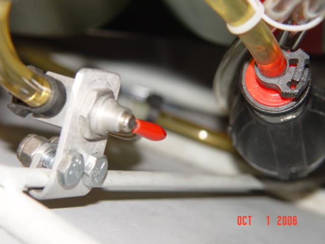

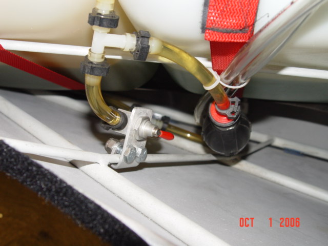

Oh yeah... a few pix at
http://smg.photobucket.com/albums/v486/flyparafan/Kolb/
Note the gap seal too, since we're having that discussion...
-Dana

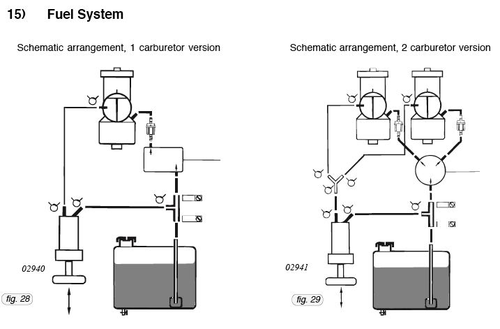

PostPosted: Tue Sep 25, 2007 3:56 am    Post subject: Re: I finally flew it! Reply with quote
Dana,
I've very glad to hear you flew without the fuel starvation problem.
The following is my 2 cents worth on primer bulbs.
Most of the primer bulb installations I've seen are either in parallel or series with the pulse pump and therefore are being used only as a hand pump to fill the float bowl. Why so many do it this way is a mystery to me since the purpose of the PRIMER is to give a little squirt of fuel into the throat of the carburetor for a quick start. Having it plumbed (either parallel or series) to the float bowl does not accomplish this.
When I bought my Firestar it had no primer at all and took many many pulls to get it started with the proper starting technique with the float bowl full. I bought a high quality PRIMER bulb from West Marine and installed it ACCORDING TO THE ROTAX MANUAL, which means it is teed off of the fuel supply line before the pulse pump (between tank and pump) and then goes to the primer fitting on the carburetor, which is downstream of the venturi and butterfly valve. I also installed a shutoff valve between the tee and the primer bulb to prevent the pulse pump from sucking air if the check valve in the primer fails.
When starting cold, I open the shutoff valve, give the bulb one squeeze (squirting a bit of raw fuel into the throat of the carburetor), shut off the valve, and pull the starter rope once and it starts. The whole purpose of a primer bulb is to get a squirt of raw fuel into the intake so it will start on a single pull when cold. Once it is running, the pulse pump quickly fills the float bowl if it was low due to evaporation from sitting for a while. The primer bulb's primary purpose is NOT to fill the float bowl which is all it will do if it is plumbed the way most folks do it, contrary to the Rotax manual. Having the primer bulb in the fuel system feeding the float bowl creates another point of potential failure, which it sounds like maybe was the problem you had. If the primer bulb is plumbed into the primer fitting on the carburetor and isolated with a shutoff valve, it is not part of the fuel supply system when running.
Attached is a photo of the 2-stroke installation manual figure showing the primer installation schematic. It shows a plunger type primer which does not need a shut-off valve but the bulb type should have a shut-off valve to isolate it in case of check valve failure.

d-m-hague(at)comcast.net
PostPosted: Tue Sep 25, 2007 9:06 am    Post subject: I finally flew it! Reply with quote
At 07:57 AM 9/25/2007, Thom Riddle wrote:
... the purpose of the PRIMER is to give a little squirt of fuel into the
parallel or series) to the float bowl does not accomplish this.... The
it will do if it is plumbed the way most folks do it...
Makes sense. On my engine (Cuyuna, with Mikuni carb), there is no primer
port, but there is a choke lever. Cold, it will start on the first pull
with the choke on. Between flights, if everything is sealed well (it seems
to be, now), the fuel line should stay full, but if not (or at initial
startup), it could take an awful lot of cranking to fill the fuel system up
to and including the float bowl.
I had considered tee-ing in a bypass around the primer bulb with a couple
of check valves, but that just adds more complication and more potential
leak points. I also considered putting in a primer hole and adding a
plunger type primer, deleting the bulb, and using the plunger primer to
pull fuel up if necessary... but it'd still need a check valve to keep from
pulling fuel (or air) back from the carburetor if the float needle is open.
One option for priming could be a tee off the fuel line downstream of the
bulb, with a valve, so that when you open that valve the bulb would force
fuel into the carburetor throat, but with the valve closed it'd still be
able to fill the fuel line and bowl.
As for putting the bulb series or parallel to the pulse pump, I guess it's

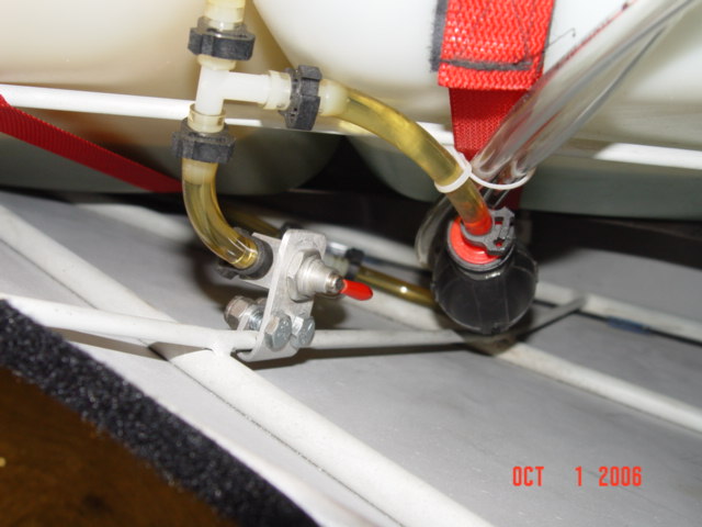

Here's a picture of my primer bulb "By-pass"
Just close the valve , squeeze the bulb , then open the valve...
