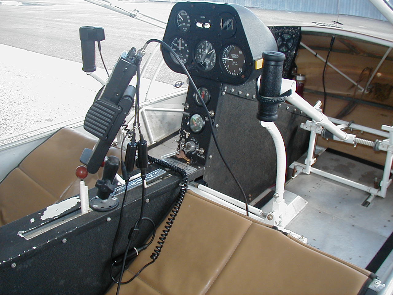

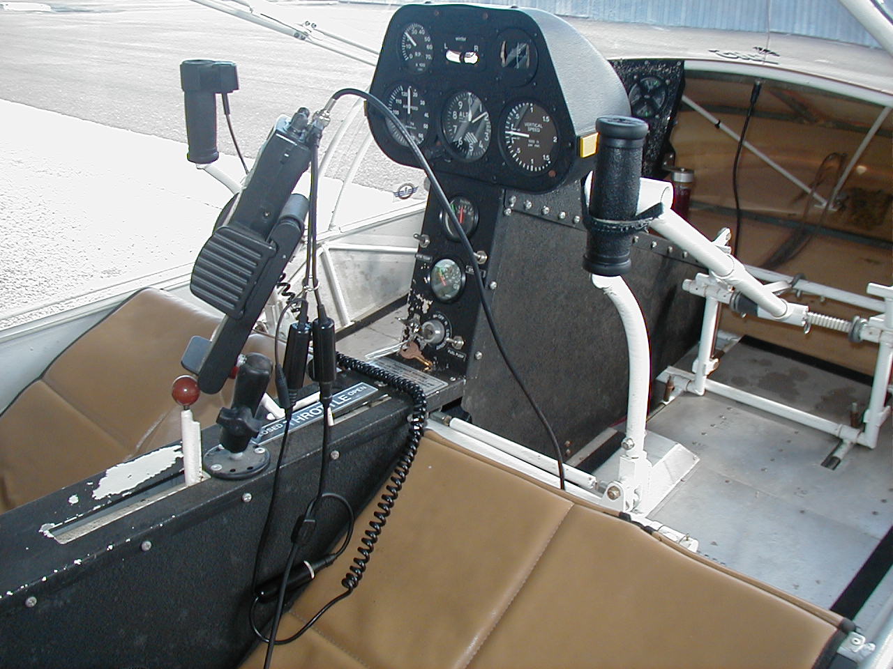

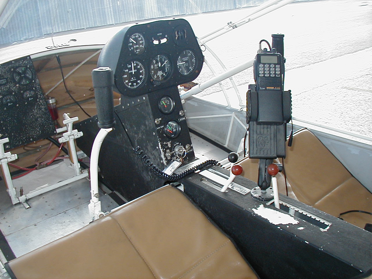

PostPosted: Wed Sep 26, 2007 6:03 pm    Post subject: Space for radio mounting Reply with quote
Hey Guy's...
Here is the way I have my radio set-up .Don't look at my automotive wrinkle paint that is all coming off. Now I get to do it all over again.I use a kneeboard that I strap to my right leg that hold my GPS and charts. It places the GPS in good viewing position. The holder for my ICOM A-22 is also in good viewing and easy to see when changing the frequencies.
I hope this helps.
Bill Futrell

pj.ladd(at)btinternet.com
PostPosted: Thu Sep 27, 2007 4:06 am    Post subject: Space for radio mounting Reply with quote
Hi Bill,
thanks for taking the trouble but unfortunately I have the central stick set up. I should have mentioned that, I suppose.
thanks anyway
Pat

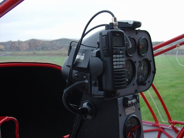

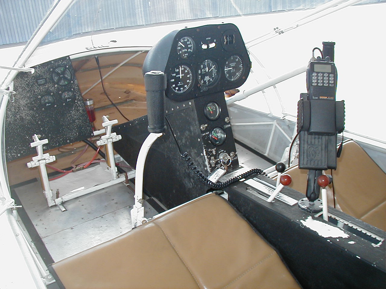

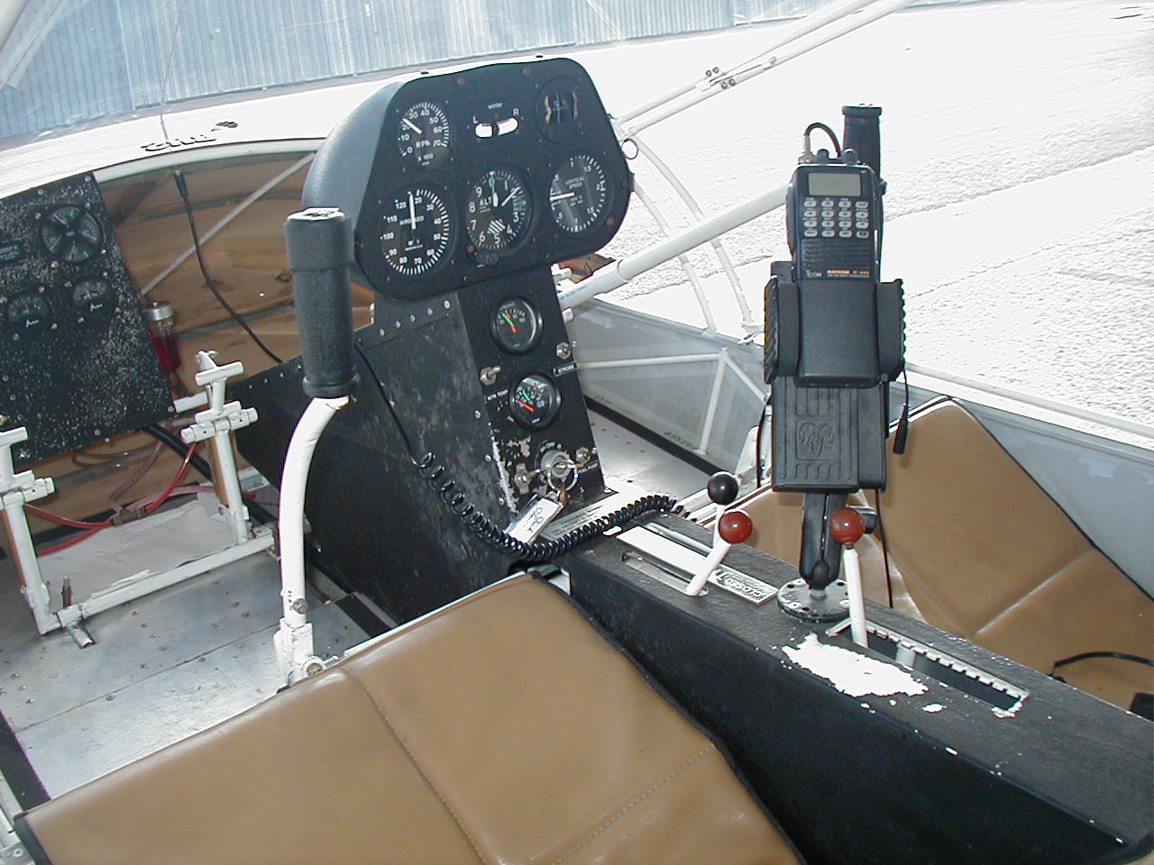

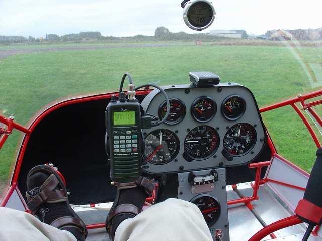

PostPosted: Thu Sep 27, 2007 11:02 am    Post subject: Space for radio mounting Reply with quote
Hi Pat, I went down to Sandtoft Airfield today to do the first 25hr service/oil change etc on the 2200 Jabiru on my Mk3 Extra, as promised I took some photos of the radio/gps setup in my plane, as you will see the Icom Ic-A24E radio is attached to the left hand side of the instrument pod, this is well out of the way when getting in and out and also does not interfere when flying, the main support is a mobile phone mounting on an 8"flexible which has a suction cup for mounting to the console, additional support for the top end of the mount is in the form of a tie wrap attaching the top end of the flexible to the small metal plate on the left of the instrument pod (just slacken the two fixing screws a touch and thread the tie wrap through) tie wrap all cables and leads to the flexible support, works a treat, firm support for the radio and easily accessible, as for your previous enquiry regarding antennas, the Lynx short flexible VHF antenna works fine although we are getting better results with an antenna from Montreal, Canada, the Miracle Whip Antenna, this is a 1/2 wave diapole antenna against the Lynx's 1/4 wave, it certainly produces superior clearer reception, the manufacturers web site is j.codd(at)btopenworld.com (j.codd(at)btopenworld.com).
