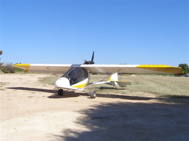

I mailed my paperwork in to the FAA to register my N177RM as E-LSA on 8-15-07. My Mk ll completed the flight worthy inspection today, 9-27-07. I have 5 hrs to fly off.......My DAR didn't like my prop bolts, didn't have enough threads showing. He said my ELT remote, needed the battery expiration date labeled on it even though I had it listed in my logbook. He wanted me to safety wire my carb bowl clips to the engine to keep them from coming lose until I told him it was part of my preflight to check for water in bowls and would have to rewire them every time, then he said not to worry about it since I checked the clips every time I flew...... He was very thorough, used flashlight and mirror, but was helpful as he had owned and flew planes like this before. Generally it was a good experience.....He told me the big rush to certify ELSA's the FAA had anticipated was not happening. Ive got a feeling used parts might be a little cheaper next year!....I know I feel so much better knowing Big Brother will be watching me now!.....All in all, Im glad I got off my lazy butt and got it done......Mike
