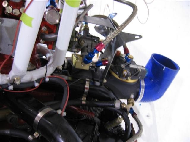

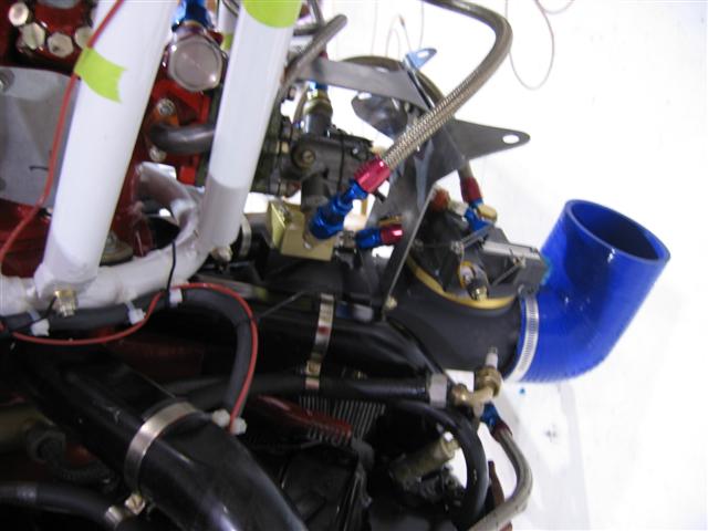

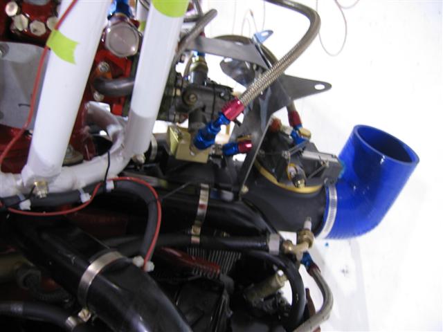

As an aside to this thread but same subject I am currently flying an M14PF (Russian Radial) that has a pressure carb and no mixture control.
These are great engines but the carbs are hard to come by and there are no parts available to rebuild them. There is nobody who can calibrate the and no equipment or instructions to calibrate them with. Not a good scenario.
So I put an Airflow Performance INc. ( http://www.airflowperformance.com/html/site_html.html ) Throttle body on it that has a mixture control. The throttle body is a close 1st cousin to a pressure carb and a step up on the evolutionary ladder to fuel injection.
The thing is simplicity itself and required no engine mods or adjustments.
It jives me additional HP and full control of mixture at all altitudes.
Now I would never suggest violation of FARs but if I still owned a Twin Commander I would be sorely tempted to slap a couple of these on as opposed to rebuilding those old pressure carbs. They make several modes for Lycomings. (experimental of course)
In the pictures attached below the throttle body can be seen with a blue elbow attached to it.
 Filesize:  67.5 KB
 Viewed:  808 Time(s)
 Filesize:  43.03 KB
 Viewed:  806 Time(s)
Milt
