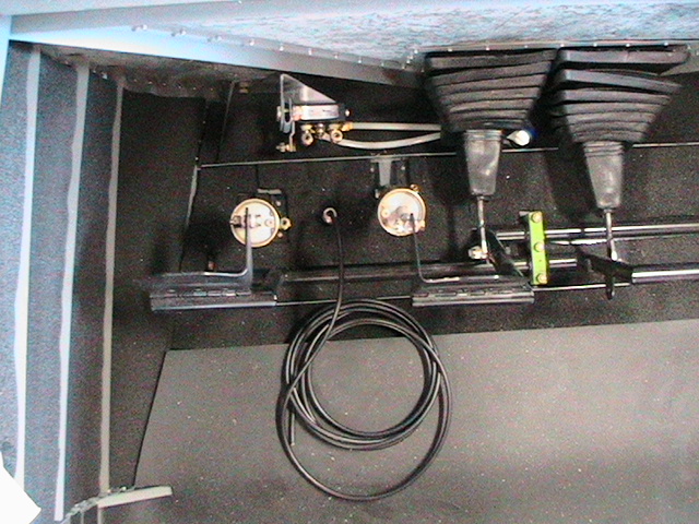

As a general guideline, the transponder antenna should be located so as to (A) have as short a feedline form the transponder as possible and practical, (B) be a couple of feet or so from other sensitive instruments which might pick up the short intensse bursts of its transmission, and (C) be at leat three feet from other antennas, (transceiver, localizer, VOR etc.).
The center C-channel under the cabin floor is a satisfactory place to install the transponder antenna and unless it is immediately behind the nose gear it should function well. I would place it at least a foot or so back from the firewall to be safe on that account.
I decided while building the fuselage that there is so damned little room for wiring to traverse fore and aft through the center section of the spar, that I would close the center C-channel support under the cabin by making a cover for it. The cover is retained by #6-32 flathead screws and nutplates. The cover allows the use of that center C-channel to run my brakelines back to the main gear legs, and to run wiring under the cabin floor and the center section of the spar rather than trying to run everything through the one small hole in its center. That hole already accomodates the aileron torque tube, the rudder cables, and the threaded rod from the center stick assembly to the elevator control horn inside the console.
Because of that adaptation, the center C-channel was not a convenient location for me. I decided instead to mount the transponder antenna in the cabin floor through the rudder pedal bearing channel and centered between the left seat rudder pedals. The pedal bearing channel eliminates the need for a doubler to support the antenna. That location places the feedline coax cable between the pedals where it doesn't physically interfere with their movement and puts the antenna a satisfactory distance from anything it might interfere with in the RF sense. It also routes the cable where nobody's feet are likely to traumatize it over time. Regardles of whether or not you use the exterior C-channel as I did or not, this site in the pedal bearing channel, centered between either set of rudder pedals remains a decent option in the 601XL.
In the photo the antenna connector and the coax feedline can be seen between the left side rudder pedals. The gizmo immediately forward of the antenna is a Matco parking brake valve. The brakelines can be seen running from the valve outlets to where they exit the cabin into the center channel conduit.
