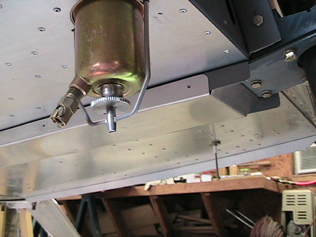

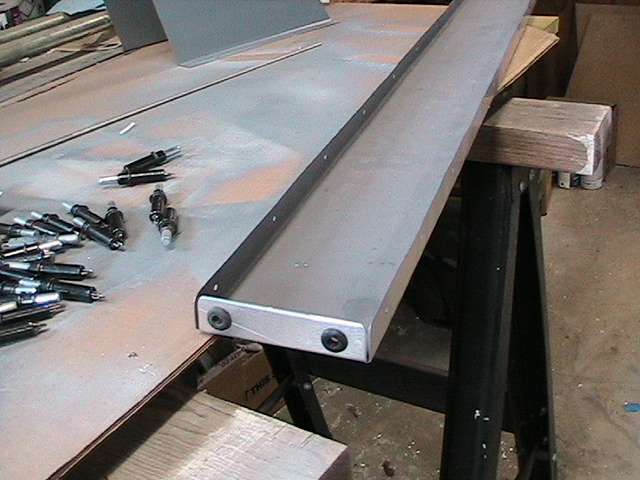

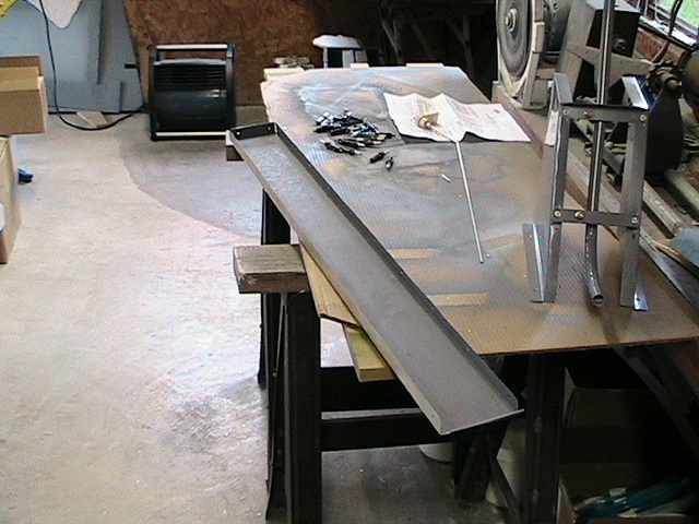

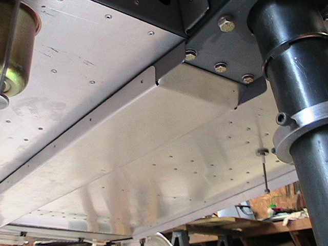

Okay, I finally got around to it. One correction from the earlier email..... I had a brain fart about the screws I decided to use to secure the cover. They are #6-32 button head stainless steel screws with allen socket heads. The nutplates are K1000-6 with countersunk 3/32 solid rivets "squoze" in place.
In the photo of the rear of the cover, the brakelines had not been threaded through their grommets yet. As the photos show, there is nothing sacred about putting the transponder antenna and/or the gascolator in the center channel. Since I am using that area to run brakelines and wiring, I mounted the transponder's little "Marvin the Martian" antenna between my left seat rudder pedals and the gascolator ahead of and between the right seat rudder pedals.
If you have specific questions, ask and I'll try to respond.
Dred
