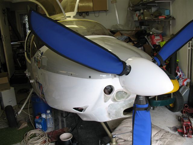

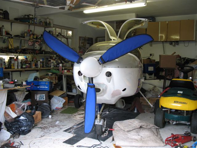

Hi! All
In part to be viewed in reply to Jos Okhuijsen's message re-Rotax 914
cooling .
The message is ready to be sent with the following file or link
IMG_0410 G-PTAG front view off centre port side new Rotax/Europa cowls
with modified Cooling air intakes.
IMG_0411 G-PTAG front view off centre starboard side new Rotax/Europa
Cowls with modified Cooling air intakes.

PostPosted: Sun Sep 23, 2007 9:03 am    Post subject: Emailing: IMG_0410, IMG_0411 Reply with quote
Hi Bob,
I noticed your ac is fitted with the Woodcomp Scimitar blades.
What prompted your choice (presumably over the Airmaster) and how are you
finding it. Is there any noticeable improvement in performance.
Are you using the Woodcomp or the Smart cotroller.
We are currently looking to fit a replacement prop and the scimitar blade is
something of a rarity amongst Europas. In fact William Mills was the only
other one I was aware of.
Carl Pattinson
G_LABS
PS: any problem with the PFA approving the installation.

PostPosted: Sun Sep 23, 2007 12:30 pm    Post subject: Emailing: IMG_0410, IMG_0411 Reply with quote
Hi! Carl
The only problems encountered at present is the 20 pages of test details
the PFA expects! If you don't remember to note "chapter and verse" when
doing the test it means doing it again. And I don't like flying with my
"head in the office"! Unable to make any pronouncements about
performance at present except with the turbo engaged the thrust is well
in excess of the MT /Jabiru range.( not proven by scientific means just
the "kick in the butt" experienced when the "taps are opened" on take
off or climb.)
I chose the Woodcomp on the basis of cost, locality for service, and
professionalism exhibited during a factory visit. The controller I have
in use is Mark Burton's Smart Avionics Controller which is working
flawlessly.
The prop. has feather facility (which I haven't used yet!) but I elected
not to have the reverse thrust capability (This is not on the top of the
PFA popularity list !) The MT was an excellent prop. for cooling on the
Jabiru but nevertheless was very expensive, and together with the
overhaul 72 month requirement and price made a change inevitable but my
mind was made up by wrecking it when my nose wheel yoke departed on
landing!
Bob Harrison G-PTAG
