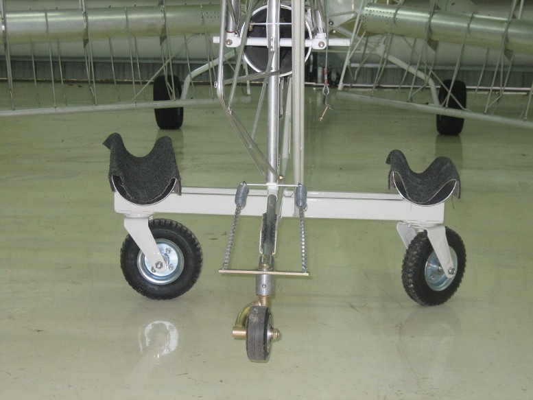

Hey thats a nice dolly Travis.
My problem is the root end or inboard of the wing leading edge hitting.
I need a way to keep the load -unload ramps in line with the trailer bed. (longer legs?)
Not wider just higher. whats the average stance with steel legs outside tire to tire?

I had same problem with my Firefly when I trailered it. Dennis Souder suggested that I crank up trailer tongue as high as possible. That seemed to work for me as it flattened incline from trailer bed to ramp.
