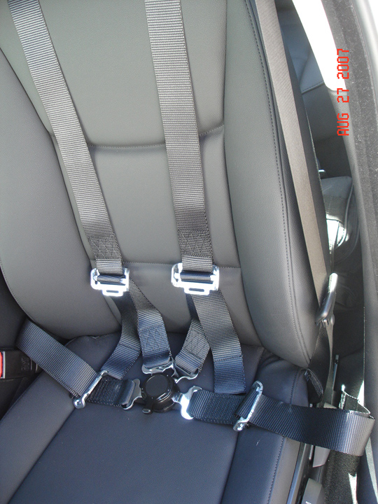

  I am not using these YET. I just cobbled these together this weekend as a test. I think I prefer the rotary belt release but didn’t want the 3” wide racing belts so I opted for the 2” belt with rotary release. Below is a photo of a set I found on ebay (sold to drifters) for $50.00 delivered. They are a 4 point fixed location belt. No retract. (retract portion below). 5 point also available for about the same price.

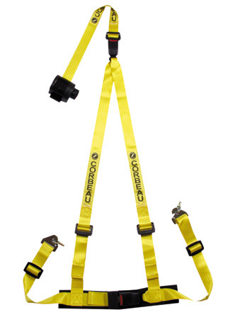

I found these retract belts online. MSRP ~$99, I think I paid $79 delivered! They are built by Corbeau and may be good enough to use as-is but I THINK I wanted the rotary release so I blended the two sets (both black).
From the Corbeau I used from the retract all they way down to the shoulder adjustment buckle.
From the Rotary Release I used from the bottom of the shoulder adjustment buckle down; including the lap belt and rotary buckle.
Note: on the Corbeau there is a quick disconnect between the Y and the retract assembly. Could be nice to remove when the rear seats are not used (lap belt stays attached)
Again the Corbeau are probably good enough to use as is but I didn’t want the basic car belt buckle which may be more comfortable than the Rotary Release (see padding behind the belt buckle).

Final note: the retract attaches with a single bolt. I believe we may have to modify the attachment mechanism.
