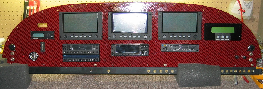

I agree with the other Rob who posted, the TruTrak DigiFlight II VSGV is what I bought, going with the flat panel display instead of the round.  I am using a three screen GRT glass display (duel Horizon II and one Sport) for a hard IFR panel.  The following is a picture of the panel, almost completed:
[img]cid:005901c633b6(at)D43G8741[/img]
The panel covering is a Kevlar overlay material.  The bottom part of the panel will also have the Kevlar overlay put on after all the break and rocker switches holes are cut.  The TruTrak autopilot is on the far left hand side above the trim and ignition switch.
Russ Daves
