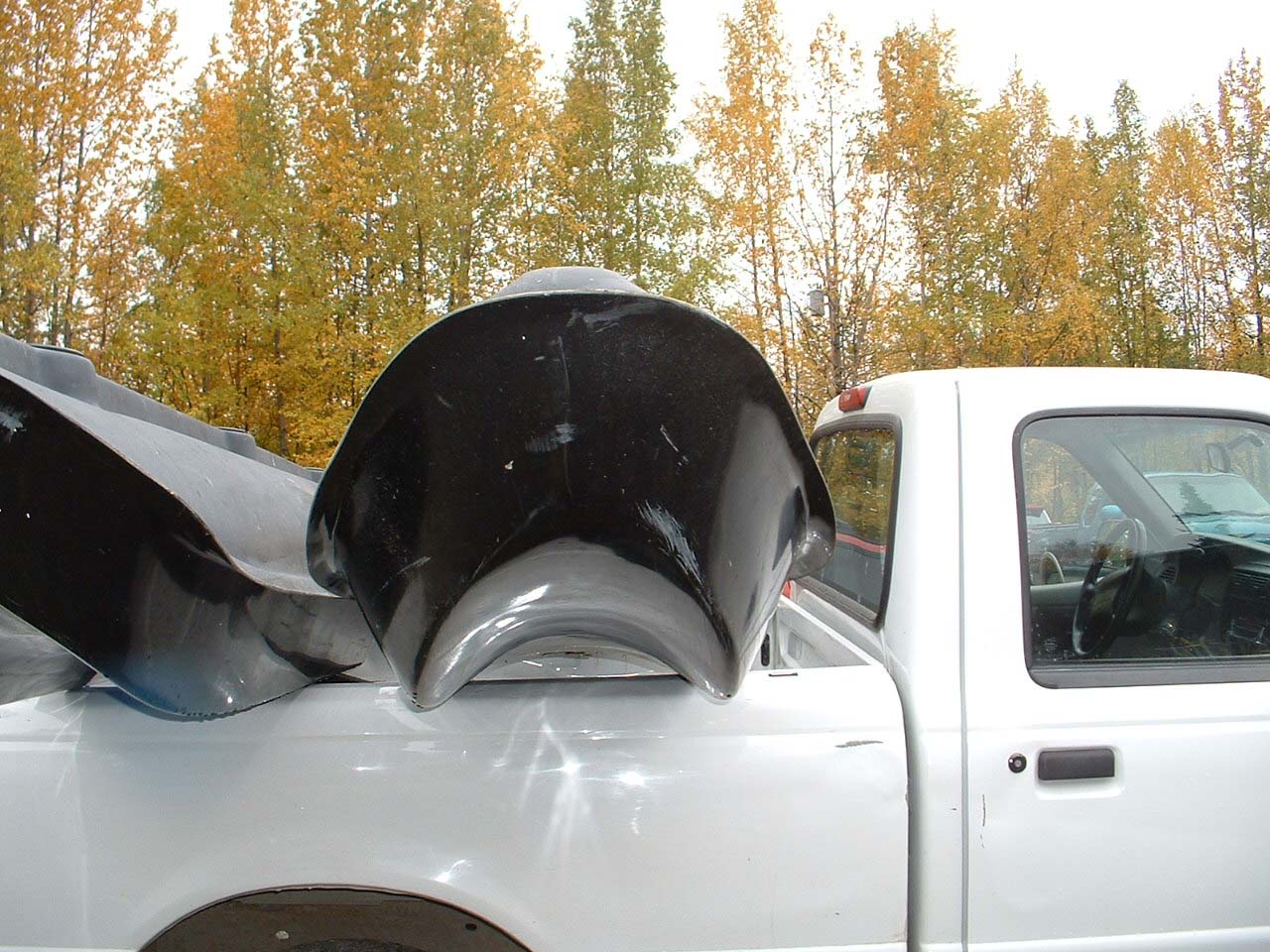

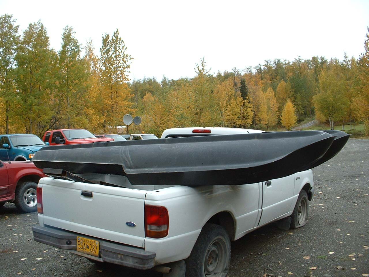

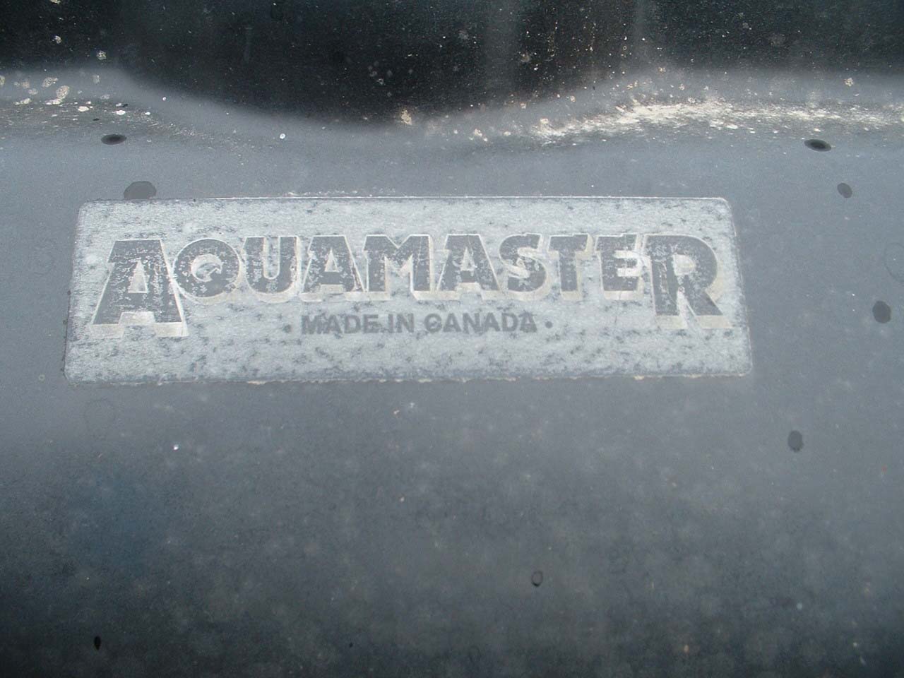

PostPosted: Fri Sep 28, 2007 1:34 pm    Post subject: Re: aquamaster floats ??? Reply with quote
here are a few pics of the floats.. I have never seen them before..
 Filesize:  126.09 KB
 Viewed:  533 Time(s)
 Filesize:  235.63 KB
 Viewed:  504 Time(s)
 Filesize:  192.83 KB
 Viewed:  526 Time(s)

PostPosted: Sat Sep 29, 2007 8:52 am    Post subject: aquamaster floats ??? Reply with quote
With that tunnel design I can see where they may be very efficient. I would
like to try a set before purchasing though. Like tunnel boats they may not
be able to take too rough water but on reasonably calm water I can see how
you could be off very fast. On rougher water they could transmit a lot of
pounding to the airframe.
Noel

PostPosted: Sat Sep 29, 2007 9:36 am    Post subject: Re: aquamaster floats ??? Reply with quote
my thoughts exactly... They are only 12' long, but look to be pretty wide so hopefully they will have enough buoyancy..I will carefully fill them with water and measure it out so I can figure out displacement.

PostPosted: Sat Sep 29, 2007 11:13 am    Post subject: aquamaster floats ??? Reply with quote
Bum a set of scales form a transport co. for an hour or two... Or even
weigh scales on the highway.
Weigh a float or a float on a trailer empty then fill to the "appropriate
level" of water and weigh again. The difference in the weight will be your
displacement. Around here the portable scales the highways department
carries for highway spot checks are more than accurate enough to read your
displacement within three or four pounds. Weighing a float can break up a
day for the inspectors.... Remember to pump the water out before carrying on
the highway though.
Anyone can see those floats are heavy. Just look at the tires on that
pickup! Wink
