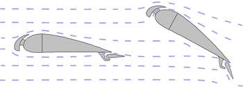

First, let us take a look at the aircraft wing. It has a fixed leading edge slat. This produces much higher amounts of lift than a regular wing but the trade off is increased drag.
Next, let us consider the full-length flaperons. Again, much higher lifting potential on full extension, coming down some 35 degrees and in effect have an "air brake" effect on the aircraft.
Although exceptionally strong, the airplane is still a very light design (ie. an Ultralight) and therefore, its kinetic energy is less than a much heavier (general aviation) aircraft. As such, once it picks up extra drag, it either requires more thrust to match or it slows down. This thrust is either with engine power, or by lowering the nose more.
In essence, if the STOL CH 701 is flying "clean" (the nice comfort zone), it flies little different to any other "regular" aircraft of its size. Once flap is selected, the geometry of the aircraft alters and as a consequence, the pilot must modify the handling – albeit slightly.
