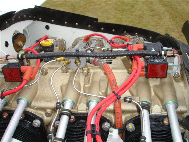

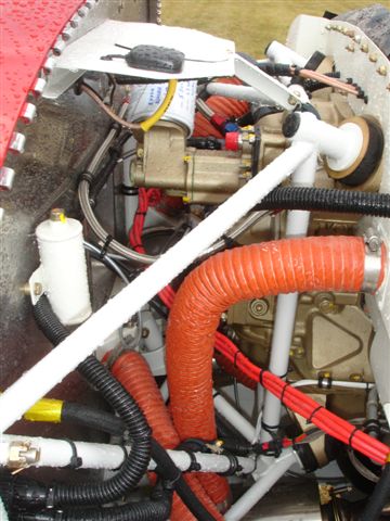

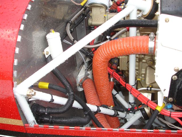

OK John,
Here some shots I took of Rick's plane at OSH. You can also view more at the link below.
Zack
