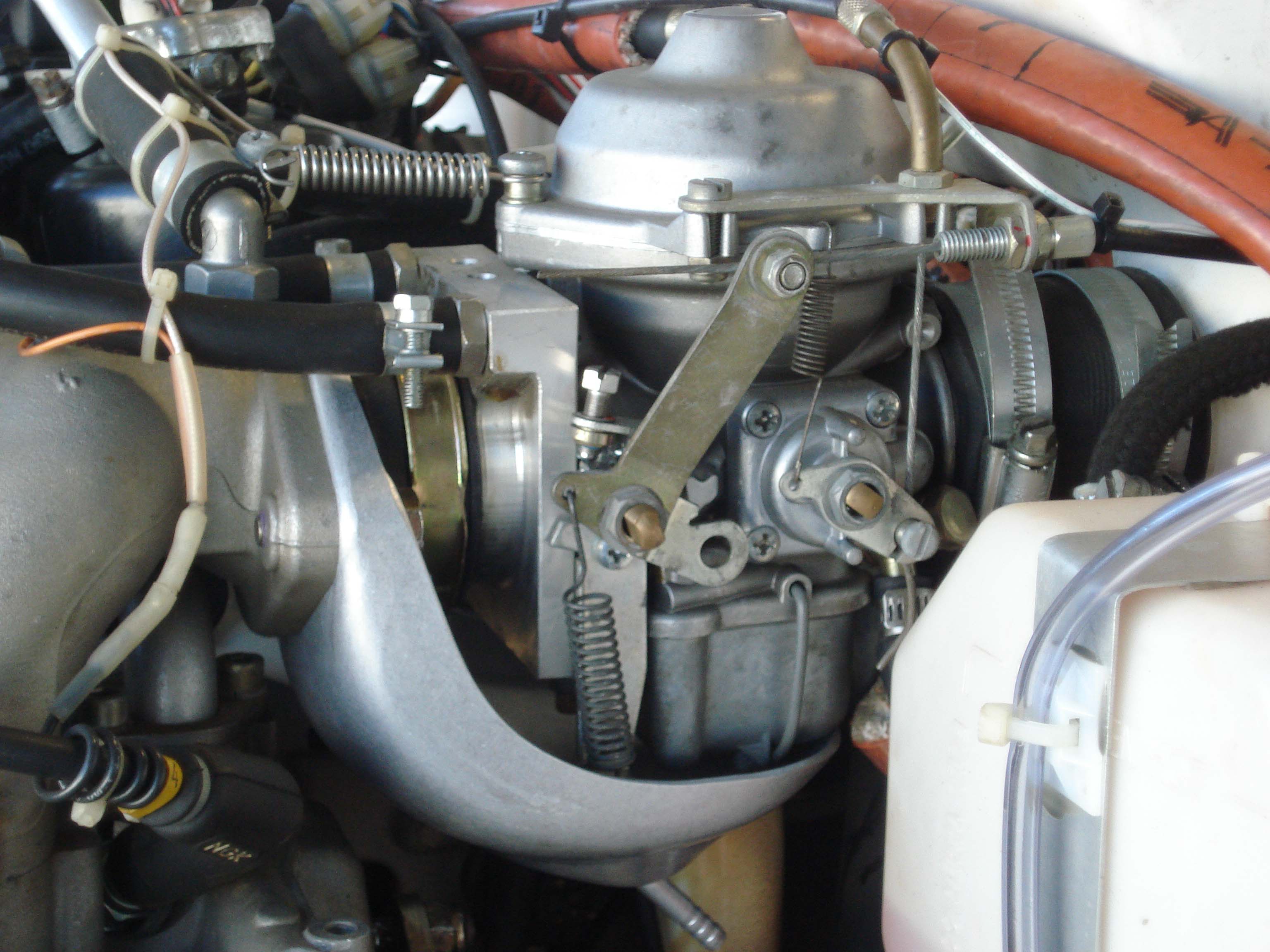

Greetings All,
I just attempted to install the factory drip tray/heat shields on my 912s.
Since this information is not published elsewhere, I am writing it here and
referring to the molded Rotax Part No. 874 300.
The standard UK carb heat system I have installed between the
carbs and rubber flange on the intake manifold prevents the
drip tray from fitting around the base of the float bowl. The back end
of the tray pushes up on the bottom of the bowl and prevents
movement of the retaining clip. Also, the tray is too short to completely
protect the base of the carb. Sufficient grinding of the back wall
of the tray will relieve the pressure and potential abrasion on the
bottom of the carb, but t will still leave the tray too short to protect
the float bowl from exhaust heat (which was my purpose for buying
them in the first place)
Since I regard the carb heat system as mandatory for the engine, the
factory supplied drip tray is a waste of $160. I am now designing a
new tray similar to the original factory tray which will work with
the carb heat installed.

PostPosted: Thu Sep 27, 2007 5:35 am    Post subject: Re: Rotax 912 Drip tray Reply with quote
To better illustrate the point, here is the factory tray installed with
the cab heat module in the intake
- The Matronics RotaxEngines-List Email Forum -

PostPosted: Thu Sep 27, 2007 6:06 am    Post subject: Rotax 912 Drip tray Reply with quote
Ira,
You might consider using the trays from the 914. You would have to work up some sort of bracket or mount as the trays on the 914 are bolted to a bracket that is attached to the intake plenum. But they would overcome the issue with the original trays.
You can see pics of the 914 trays on my build web-site http://www.europaowners.org/N914XL
I believe there's a decent pic at the bottom of the first image page of the last album. There are probably better pics in the engine installation section if you want to rummage around a bit.
Hope this helps.
Good building and great flying,
Bob Borger
