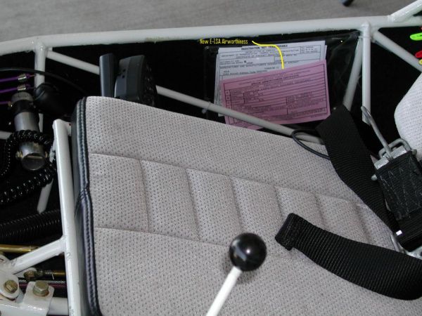

With the deadline looming, I got off my butt and got to work. The process took me about 2 months from submitting for the registration to getting my certificate. (I got my FSII an E-LSA certificate a few weeks ago)
I bought the EAA transition kit and I found it helpful. The forms are straight off the FAA website, but what is helped me is the tip sheet on how to fill them out is included. This was all basic stuff, but I did not check any wrong boxes and the paperwork was all in order.
I used the "Affidavit of Ownership" for my Registration even though I could have come up with the receipts. Sample was in the kit.
I did the condition inspection and signed it as the "owner". I used the generic form from the kit.
My certificate lists the manufacturer as "Kolb" and the data plate says the same. This is how the kit instructed me to complete the documents. You can look it up N24989 to see.
I used the format for the W&B from the kit and did not use the Kolb % format. It is the same thing, but presented in the FAA way.
I used the "program letter" from the kit.
Joe Noris at the EAA was helpful giving me advice and answered some paperwork questions I had. My W&B did not work out with a "170 pilot" and Joe told me it must. I added 12# of lead strap to the nose and that cured that.
I was lucky to have the FAA FSDO office in town and one of the guys said he would do the inspection for me if he picked the time. So when he gave me the date and time I made myself available too.
He did a walk around the aircraft, looked at the controls, moved the controls, asked a few questions, looked it over again and we went to the paper work. He said it looked fine.
My plane had 9TT so he issued the Operating Limitations w/o a Phase 1 and really no limitations outside of the the LSA rules. I needed to endorse the log book that it flies.
Gave me the pink slip and told me to fly away and be careful.
I know the local DAR charges $500 (what I heard anyway) and another, about 150 miles from here quoted me $300 + Expenses. The FAA FSDO charged me $0, but I do pay a lot of taxes for this.
So now I am legal and I was able to buy real liability insurance. If I land it in the bean field I do not need to worry about someone dialing 911 and the sheriff and the FAA showing up.
I found a lot of good advice reading the list and some of you helped me off-list. Thank you all.
Jim

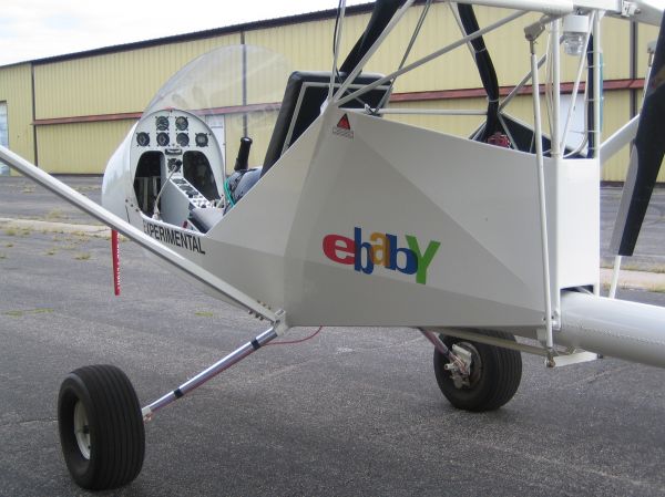

Luck .... not really. The FAA guy I happened to know from his days as the Dir of Maintenance where I keep my traveling plane. So it did help knowing him. But he still followed the book.
I must not have read the instructions all the way. I put Kolb as the manufacturer and never gave it a thought. I did not build it all, it came via a kit plus it was a in-process project that acquired and brought it to completion. I am happy to have Kolb on the registration.
I was looking at the EAB but the DAR told me that he probably would not give me repair authority so the E-LSA looked like the best fit. Or I could have created the documentation to satisfy the DAR.
When I found this plane, I had intended to have it a UL. But it was fat and no way would it ever make the weight. The LSA was a great opportunity for this plane.
Again, thanks to the K Listers for the help.
Jim
Body "nose art". I bought so many parts off E-Bay, the name was fitting.
