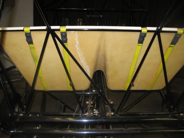

PostPosted: Sun Sep 02, 2007 8:22 pm    Post subject: Seat Reinforcement Reply with quote
I used nylon lifting straps.
Jim Series 5 0-200 building.

PostPosted: Mon Sep 03, 2007 2:43 am    Post subject: Seat Reinforcement Reply with quote
Very nice Jim. What are those attachments on the straps that you used?
Deke Morisse
Mikado Michigan
S5/Subaru/CAP 355+ TT
Subject: Seat Reinforcement
Lake Elmo MN.
jezim(at)pro-ns.net
PostPosted: Mon Sep 03, 2007 7:09 am    Post subject: Seat Reinforcement Reply with quote
3/16 pop rivets with 5/8 heads. Covered with heavy duty shrink wrap.
