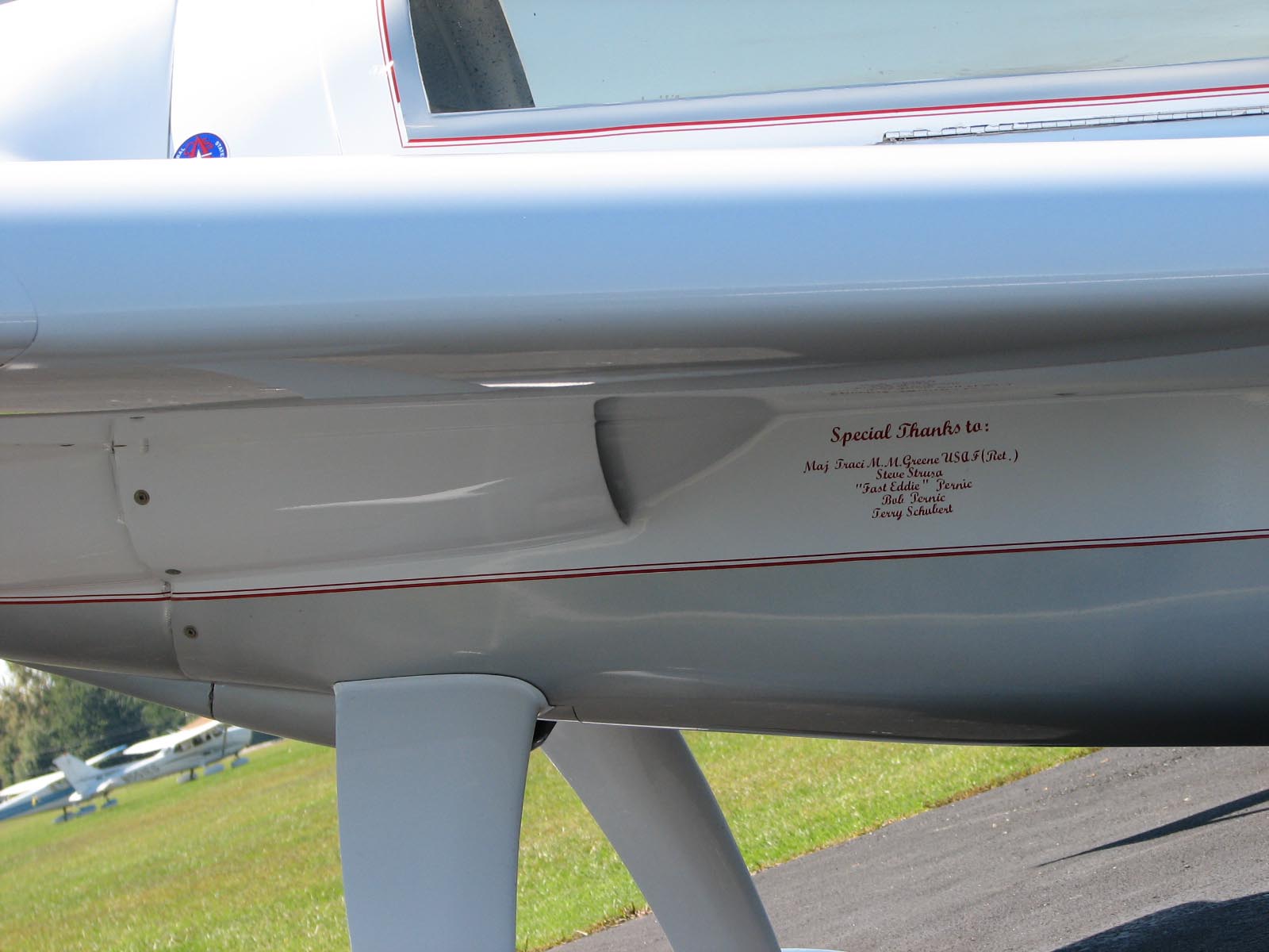

Have a look at the cooling air inlet on this Long EZ, this efficiently
cools a 160 hp Lycosaurus and only needs about 8 square inches a side to
cool all four cylinders. The key is pressure recovery and good sealing.
High pressure to force the air through the fins and nowhere else.
