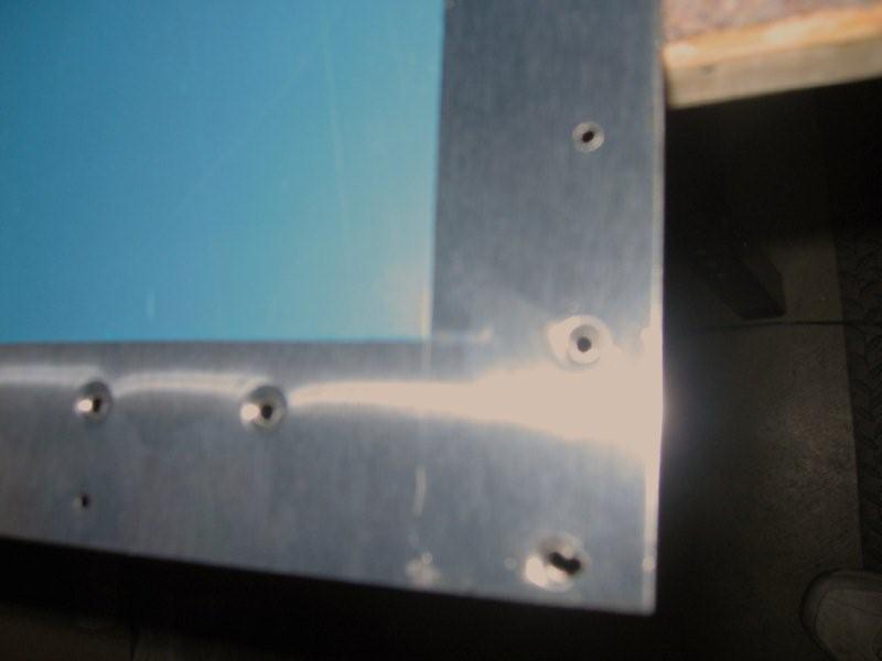

While dimpling the skins of the elevator, I started getting tired and was pushing myself to complete the tasks at hand. As you might suspect, Murphy showed up and I screwed up. The attached picture isn’t all that good, but you can clearly see that I missed the hole and it’s now elongated. This is the bottom outside corner of the trailing edge of the elevator.
I see my options as:
<![if !supportLists]>1. <![endif]>The anal perfectionist in me wants to order a new skin.
<![if !supportLists]>2. <![endif]>Find a way to make a repair that doesn’t look too bad.
<![if !supportLists]>3. <![endif]>Whatcha worried about, just keep building, the proseal will keep things together.
Thoughts, comments?
Bob

Any chance you can drill it to a 30 and use an oops rivet?

We’ve all been there. Looks like you can drill it larger and use an oops rivet. If you can keep it smooth and the trailing edge is not out of whack, it’ll fly. Keep on building.

My concern is that the where the other hole is located is right at the rim of the dimple. It appears that the factory head, even for an oops rivet may not cover the mistake. Also, this is the bottom skin, so it should have the shop head of the rivet on this side (remember this is the trailing edge). The shop head of an oops rivet will certainly be larger.

I ended up filling all of the trailing edge rivets with either metal filler (Evercoat) before priming of with polyester filler (Easy Sand) after priming. You may be able to just fill this during finishing.

As was already mentioned, it is the bottom skin, so the shop head of the
rivet will fill it. You can either use an Oops rivet or just use a longer
#3 rivet to fill the additional area. If you are worried about looks,
that will probably be filled when you fill the seam between the fairing
and the skin on the elevator. I don't know that I would be too worried
about the structural aspect of it. If you were worried, then you could
add an additional hole between that and the next good hole, although this
might be best done after the trailing edge is finished, in which case you
would need to machine countersink both sides, in which case the shop head
might not hold well on the bottom skin anyway. I doubt it is worth
replacing the skin, but that's up to you.
In the future, if you miss a hole, make sure to do it in a place that can
be easily filled with a simple rivet through the skin. Smile

Like everyone else is saying, rivet it and move on, you will have proseal and several other rivets to hold the trailing edge together. But in my opinion, I would not use an oops in the trailing edge because you would have to enlarge the hole in the wedge, and this is already a tight area. I would do as Jesse recommends and put in a slightly longer rivet, and be careful when setting it, so it does not cleat over and then fill the exposed hole, which is already backed by the wedge with proseal and sand it flat.

If you use an oops on the wedge, you will end up with the shop head side being way too big on the backside that is exposed for people to see, IE it will be real easy to see a -4 shop head when everything else is a -3. If the small extra dimple is bothering you, wait until you have a -4 in a line of -3's....but by the time you get to the end you will have forgotten about it, right up until Smoozer comes up and looks at the trailing edge and asks what you did there! LOL

Actually, Rick has given a suggestion that hasn't been mentioned here yet. Since he fiberglassed his tips, the last rivet will be hidden under the transition, so whether or not I use a longer rivet or an oops rivet, it would be hidden and add additional support.
The lesson I learned that if you get tired, just stop, even if you only have a little bit more to complete the task at hand.
Thanks for all the feedback!
Dan
larger.
Murphy showed up and I screwed up. The attached picture isn't all that
good, but you can clearly see that I missed the hole and it's now
the elevator.
1. The anal perfectionist in me wants to order a new skin.
2. Find a way to make a repair that doesn't look too bad.
3. Whatcha worried about, just keep building, the proseal will
Thoughts, comments?
Bob

PostPosted: Wed Aug 29, 2007 6:40 am    Post subject: Dimple challenged tonight Reply with quote
It is only there for alignment during the riveting, but it will also add some adhesion, plus it will fill the hole and is sandable/ paintable.
Dan

indigoonlatigo(at)msn.com
PostPosted: Wed Aug 29, 2007 12:18 pm    Post subject: Dimple challenged tonight Reply with quote
Exactly my opinion aswell.
One additional thing you can do is glue in the fiberglass wingtip to take
more of the strain off the corner rivet with the bad hole. Make sure to glue
both rt and lf wingtips to keep it all syimetrical. make sure your botched
dimple fits well into the wedge countersink!!!!!!
This will not even show if you do a good job.
Remember, In WWll, a bullet hole in the skins didn't ground a plane and they
didn't put a new skin on either.
John G. 409 Hiatus, Last soaring day coming up this weekend.
sand it flat.
Just my .02
Dan
