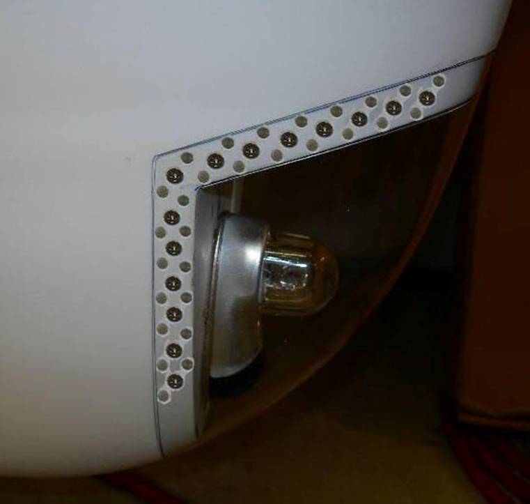

I thought it needed more screws. Here are links to two photos.
<http://lrosen.nerv10.com/Construct/Log/Wings/Tips/slides/2005-12-10_RV10-014.html>
<http://lrosen.nerv10.com/Construct/Log/Wings/Tips/slides/2005-12-10_RV10-015.html>
Larry Rosen

That really looks great, Deems. Is that your airplane? What is the material that is covering the nut plates?
David
On Wednesday, August 29, 2007, at 05:53PM, "Deems Davis" <deemsdavis(at)cox.net> wrote:
_________________ David Maib
RV-10 #40559
New Smyrna Beach, FL |

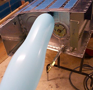

I also thought we needed a few more screws:
That should do it!
Robin

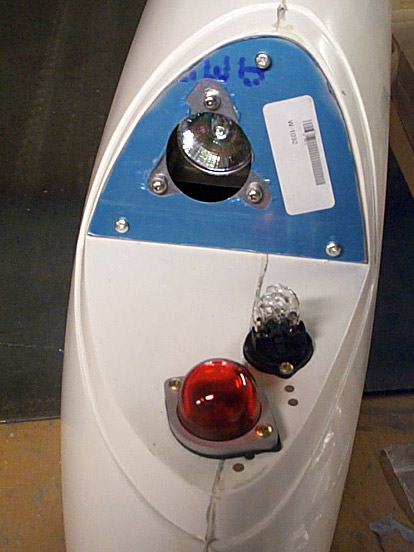

Thanks, all. I'll try the cutoff wheel approach I think. I got the strobes (from strobes-n-more with controller for $149 total), position lights (from SNF vendor with glass globes for $50 each, and the halogen landing lights installed. Took time out tonight to pressure test the fuel tanks using the valve and balloon and soapsuds method. Pleased to report it worked wonderfully and I have not a single leak! Now to screw the fuel tanks back on completely and install the heated pitot ('50s era Kollsman) before attacking the bottom skins. That's the plan this weekend - finish the wings!
OK, now - any suggestions on where to find glass globes to cover the strobes? I know it'll be inside the plexiglass but think extra protection is in order...
