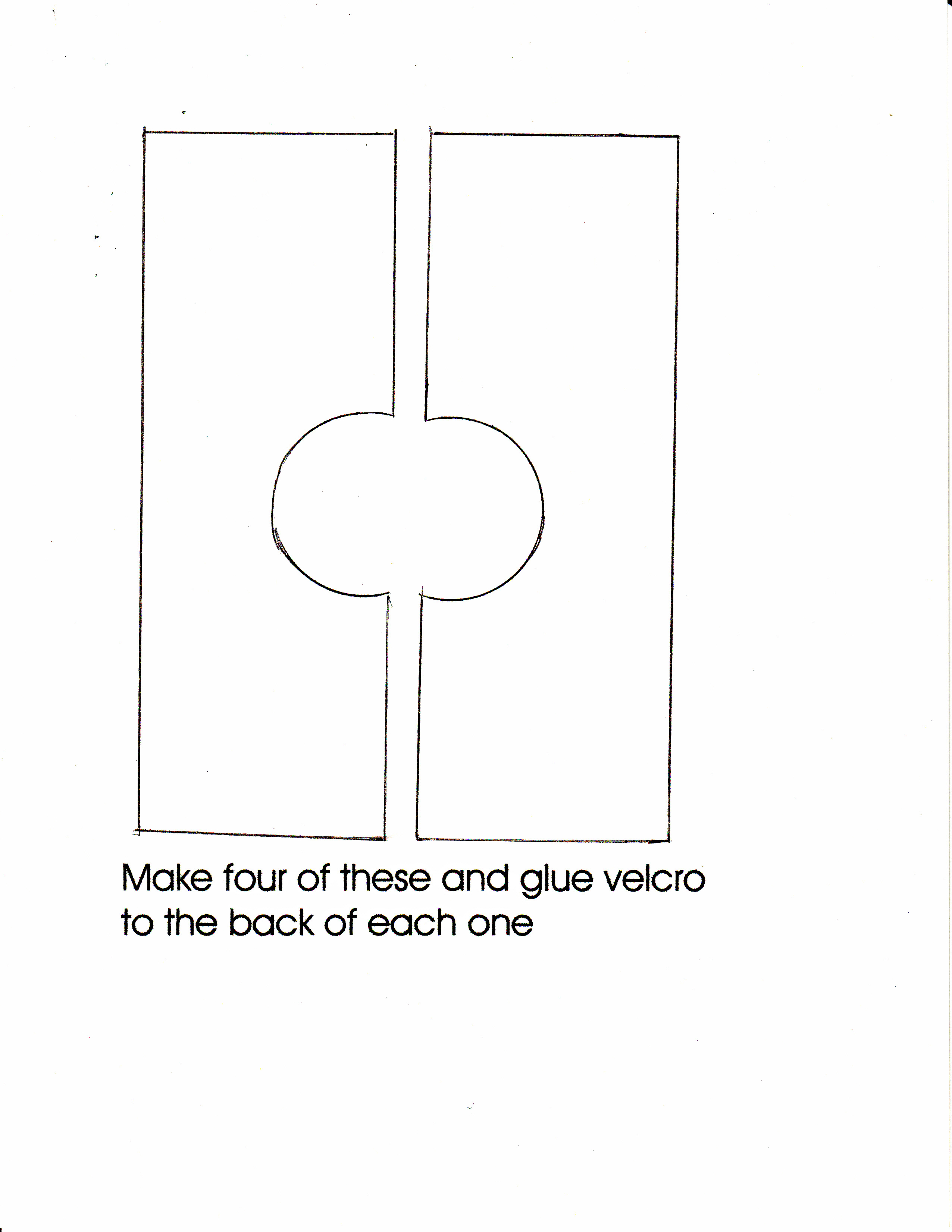

When I first got my Zodiac601XL I had a real problem with heat in the cockpit and found that most of it was coming from around the two steering rods where they go through the firewall. I don't understand why the designer made the slots so long because the rods have very little up and down movement during use. I glued velcro on the firewall on each side of the rods and used leather cut as per the drawing to close the holes. I also bought two plastic vents from Aircraft Spruce and installed them in the forward lower part of the canopy and this solved my heat problem.
