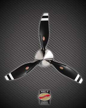

PostPosted: Mon Aug 27, 2007 4:17 pm    Post subject: Three Bladed Hartzell & IO-540 Combination Reply with quote
I didn't know one could purchase the three bladed carbon Hartzell (one used
on the turbo cirrus). I asked the rep at the AOPA convention and was told
(unofficially- but honestly)that they were expensive; at the time, only
being used "custom" for the Cirrus; and that there was no real advantage
anyway to the blade for a RV-10 versus the 2 blade. "Advantage" being
performance and weight was slightly better than the 2 blade but he couldn't
justify the additional costs when there were other composite 3 blades that
were far less expensive anyway.

PostPosted: Mon Aug 27, 2007 4:49 pm    Post subject: Three Bladed Hartzell & IO-540 Combination Reply with quote
Patrick;
Your subject line states "Three Bladed Hartzell", we are all responding
accordingly. There is indeed a three bladed carbon reinforced blade,
http://www.airframer.com/news_story.html?release=796 and Jesse is right , it
is cool!
Don't confuse this with the MT composite blade. The cost is more in the 8-9K
range for that blade after one gets it from Germany and assembled.
Pascal

This blade was specifically designed for the GA market but that means
certificated (TCDS) manufacturers, not for Experimental Kit Built -
hence the brusk treatment.
They said ask VAN to request it or go away. I suggest we ask VAN to
supplement the MT choice for three blade composite choice.
John

jesse(at)saintaviation.co
PostPosted: Tue Aug 28, 2007 6:57 am    Post subject: Three Bladed Hartzell & IO-540 Combination Reply with quote
I don't know if this is just for testing or actually available for
customers, but I saw the 3-blade Hartzell on an IO-540 Maule, I believe,
when I went to visit the factory recently. It definitely is the coolest
looking prop I've seen on a small plane, but for 3 times the MT price and 4
times the Hartzell 2-Blade metal blade price, I don't see it being used a
whole lot on RV-10's or Maule's, even if it does become available, although
some would likely fork over the cash to have something that "special".
