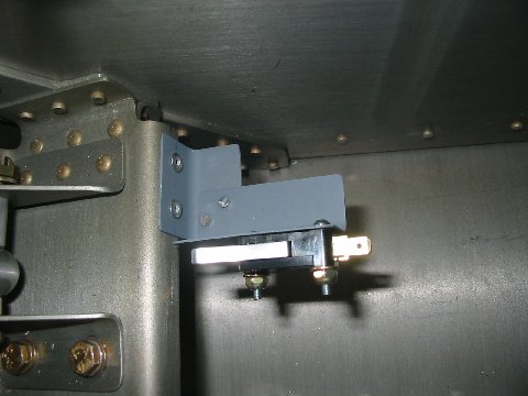

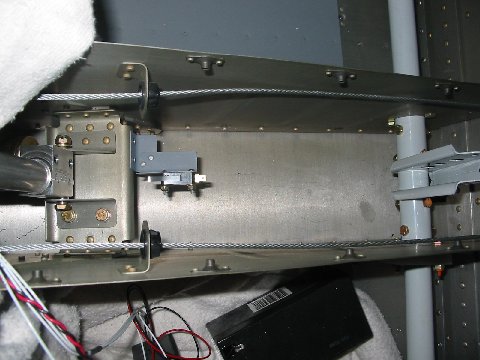

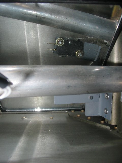

PostPosted: Thu Aug 23, 2007 3:35 pm    Post subject: Flap switch install? Reply with quote
Here's where I put mine (pictures attached). Note, one picture has a mirror in it to show switch actuation on the bottom of the flap actuator.
For guys on the digest, go to http://forums.matronics.com and search for this thread. The pictures are available there.
-Jim

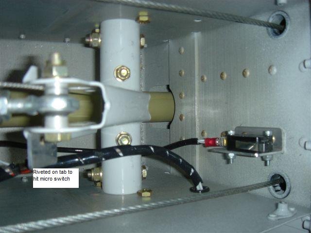

PostPosted: Mon Aug 27, 2007 5:32 pm    Post subject: Flap switch install? Reply with quote
Here is what I did, hopefully you can see it in the picture. I riveted a tab on the end of the flap horn (left side of picture) and it hits the switch on the right side of the picture.
-Mike Kraus
