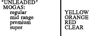

David , I tried to find the transport Canada letter explaining the Octane loss of Mogas. >From memory after
a week 95 = 94
two weeks 95= 92
3 weeks 95=90
4 weeks 95 = 87
5 weeks 95 = 84
3 mos – use only to start fires
And so on. Plastic containers lose octane a lot faster then steel kept in dark and cold. Short of it, is simple, after 2 weeks never add this gas to your plane, after 3 mos never use this gas in your lawnmower as mogas separates and creates varnish. IF your going to store your fuel for more then 3 mos for your car or lawnmower add fuel stabilizer. Then you are good for a year, give or take a month. Also be aware in northern climates and in Canada Especially we have 4 different blends of fuel depending on the season. EACH BLEND WILL AFFECT CARB ICING TIMES.
In short , only buy your gas from a busy station. Never store for more then 3 mos without action. Never trust that the high grade of fuel you just bought at a gas station is new mix and fresh.

Boy Mark, that blue stuff looks better all the time. Very Happy
