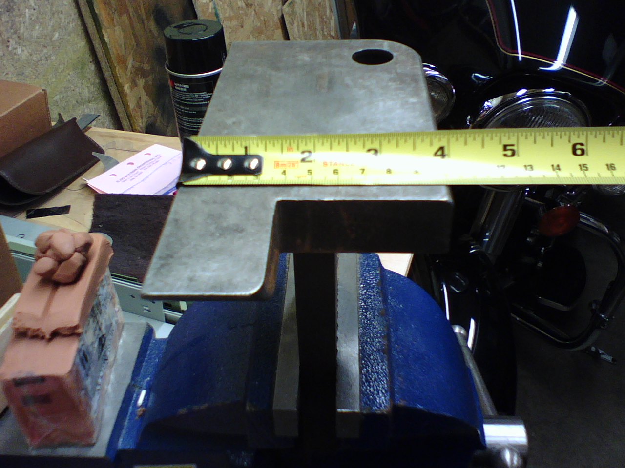

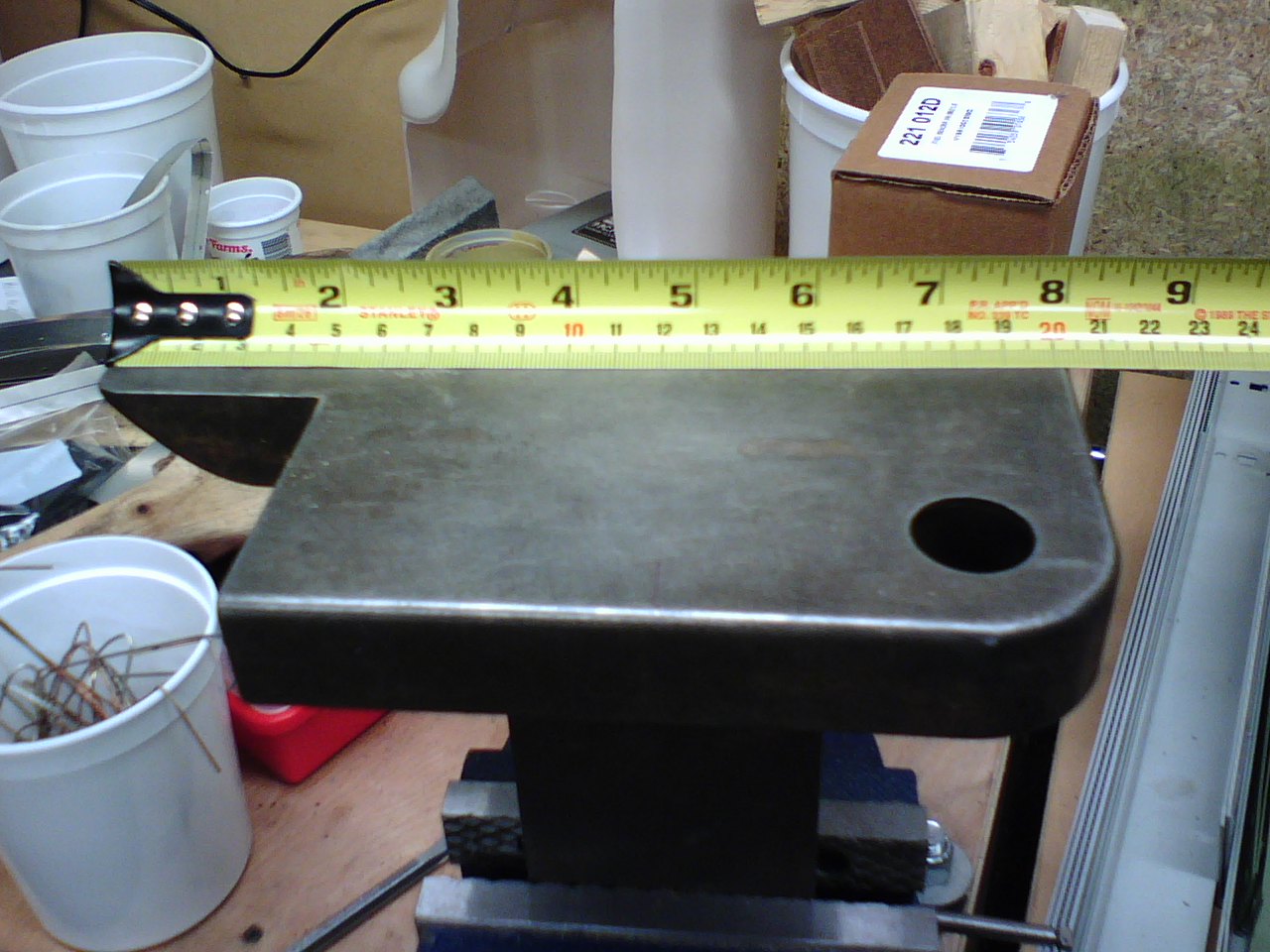

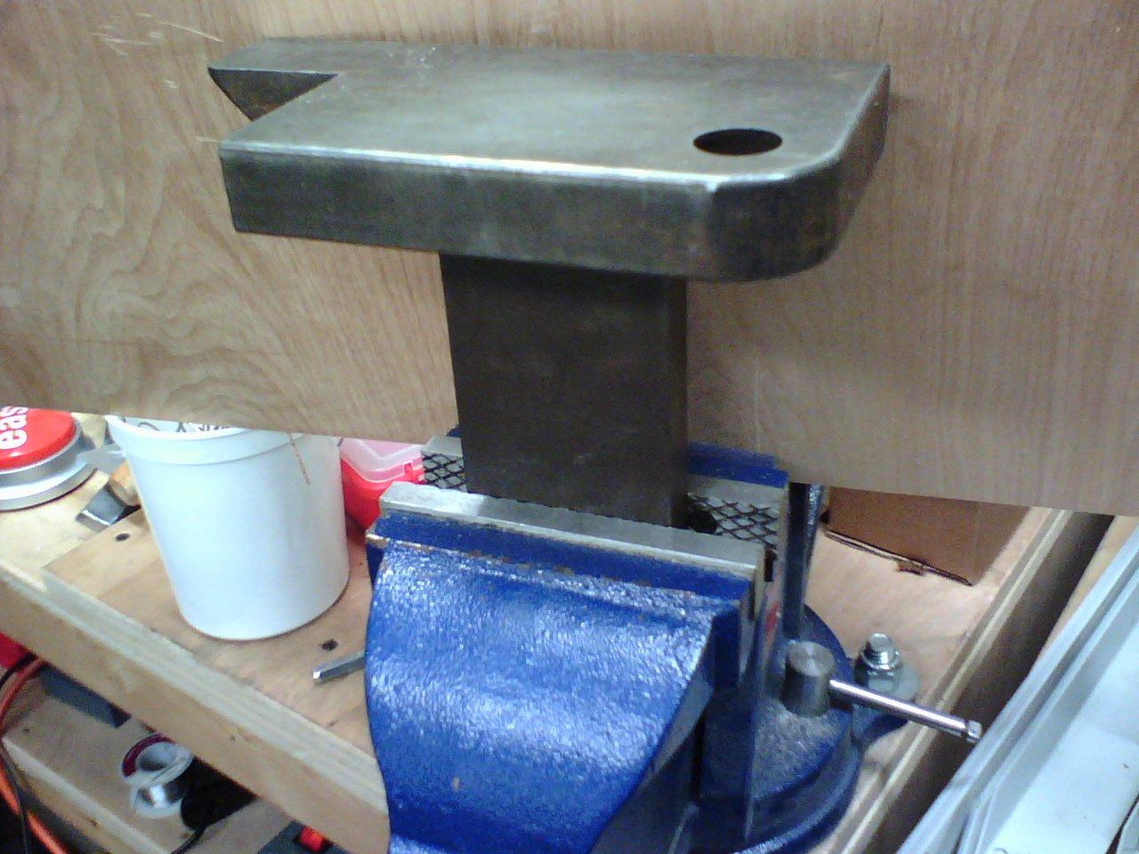

I would use a finishing hammer or dress the ballpeen to a polished soft spot surface. What I mean by soft spot is the amount of crown on the hammer face, think very large radius.
Below are some pictures of the handiest tool I have. It is a 1" X 4" x 8" tool welded to a 1" x 4" post that clamps in the vice. The left end has a snout shape and a sharp radius along the back edge. The front edge has a .125 radius and a 7/8" hole and radiused corner on the right front. It is hardened and it is used often because it is flat and tough.
I used it and a soft spot hammer to stretch some angle for the "Frame bottom edge of wing tip", no marks on the side against the wing skin.
