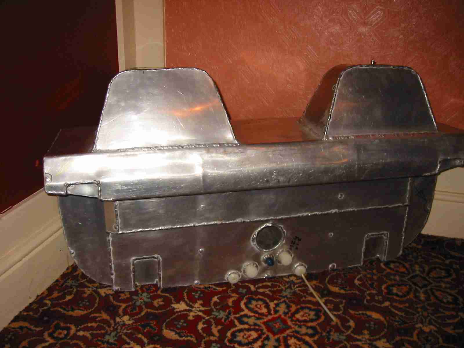

Now for the real question. Ever since Europa Lakeland went away with John Hurst I had blown off the idea of getting OEM parts and just figured I would fab every thing myself. A fuel tank would be kind of tricky, though I do have a buddy who is a real artist when it comes to welding aluminum (or aluninium for you other guys). Has anyone done this? Making the seat back 2 to 3 inches higher with a higher tank would give better back support with an increase in capacity.

Attached is a picture, taken in 2003, of an Ali tank which I believe was made for Nigel Graham.
Ian Rickard #505 G-IANI XS Trigear
