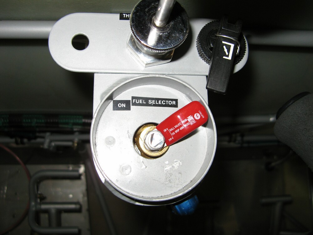

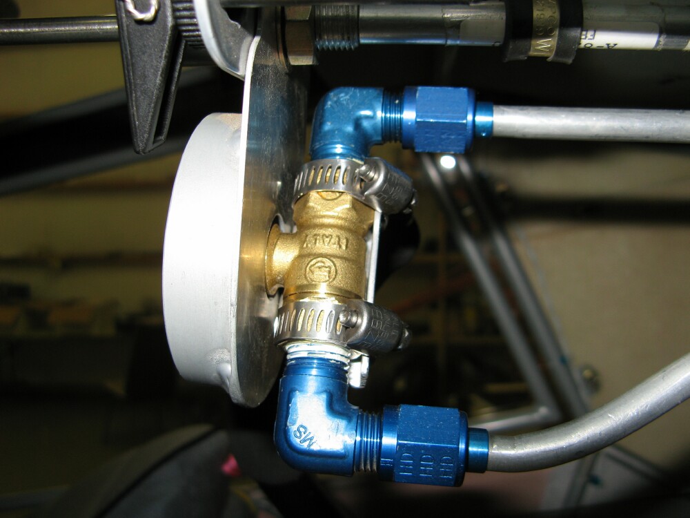

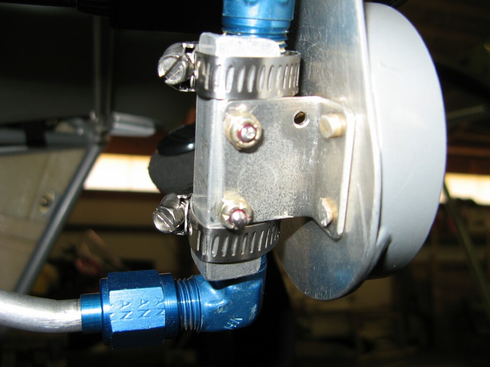

Tom Jones
Joined: 12 Mar 2006
Posts: 752
Location: Ellensburg, WA
PostPosted: Thu Aug 23, 2007 10:48 am    Post subject: Re: S5 Sticky fuel valve Reply with quote
C'mon guys, what are you using out there?
Three pictures worth 3000 words. The aluminum angle is 1/2 x 1/2 x 1//16 and is the same length as the hardware store ball valve. It is attached to the original skystar valve angle mount with two #4 screws and lock nuts. The selector handle is shortened to fit in the protector bracket.
 Filesize:  123.89 KB
 Viewed:  701 Time(s)
 Filesize:  119.14 KB
 Viewed:  659 Time(s)
 Filesize:  122.18 KB
 Viewed:  637 Time(s)
Tom Jones
Classic IV
Ellensburg, WA
