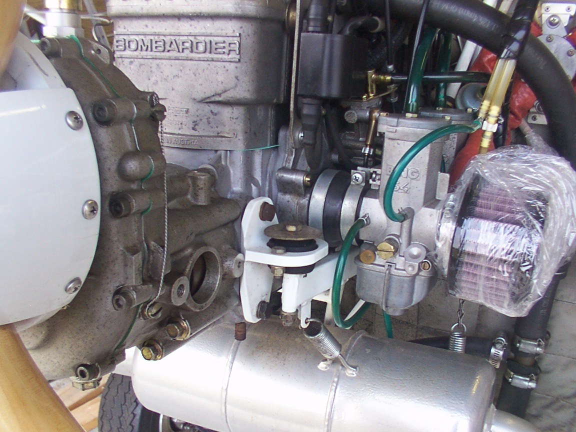

I wrote a message on 7 July entitiled "Finally I flew my airplane". This is an update and comments are welcomed.
I traveled to Oshkosh and talked with folks. To address the apparant low reading airspeed indicator, It was suggested that I vent my static port behind the dash, rather than use my new Skystar static port tapped just under and forward of the left horz stab. I will do further testing prior to that.
I spent an afternoon with a friend of a friend who knows 2 cycle engines. To my surprise, we found the throttles clearly and visibly mis-matched at an intermediate position. I had matched them at near full open and at the idle stop. Either they are not moving up and down at the same rate, which would seem impossible, or the gremlins got hold of them after I initially set them. Re-adjust made a big difference, stopping the skip at the high end completely. There was still an inconsistency at the low end (less than 3000RPM and more on that later). To me it seemed like a spark plug firing intermittantly. This guy called it "4 cycling" and said it was something 2 cycles do when the carbs need adjusting and it meant that a spark plug was firing only every other stroke. He noted that my throttle to carb linkage was imprecise. He saw that the fulcrum that splits one cable to three was cantilevered several inches and the arm would bend very slightly with throttle movement. He asked me to attach a brace to stop ancillary movement at that location, which I have since done. He sent me to these sites which I have seen before, but it has been a while .
http://www.ultralightnews.com/enginetroublshooting/techtips/techtips1.htm
http://www.ultralightnews.com/enginetroublshooting/techtips/techtips2.htm
Contained in these links are links for the recommended jetting settings. I may as well include that one: http://www.ultralightnews.com/enginemaintenance/bingjet.html
My jets are right, but I have questions about the air screw. The chart shows a setting of 1.0 for a 582. Does that mean one full turn from all the way in? The second link above contains this quote:
"This air screw changes the air/fuel mixture by changing the ratio of air to the idle jet circuit. Turning the screw out with lean the mixture while turning it in richens it.
After referring to the jet chart you have a position to start from. With the engine warmed up and idling and the screw set to factory specs turn the screw out very slowly - the engine should start to pick up rpm as you lean the mixture out. If nothing happens the low speed jet is probably plugged, or the small atomizer hole located in the throat of the carb on the engine side is blocked.
Once you have the engine idling at its highest and leanest setting using the air screw turn the screw back in 1/8 of a turn which will richen it up just enough for the best performance.
Note it is usually necessary to do this three or four times a year, do to the difference in air that you get in spring/summer/fall/winter. Note that on the 582 Rotax I have found that 45 and 50 idle jet work better than the standard 55 especially in winter. On the 582 the lower jet sizes have been shown to improve starting and help eliminate the rough idle."
I might have trouble finding a volunteer to turn those screws while the engine is running.
I asked several questions at Oshkosh about shimming a GSC prop due to tracking beyond recommended limits of 1/8 inch. I found one person who had shimmed due to tracking, and he said that he never noticed vibration when it was out of track, but he shimmed to make it right. I have since added a .010 shim of copper, per Rick at GSC and made my tracking right as well, but the vibration, presumed 4 cycling, persists below 3000 RPM. Another distractor regarding vibration is the old flat plate engine mount design. Can anybody provide information about why the flat plate was upgraded to another arrangement?
When we first started the engine, some months ago, and pitched the prop, we put a strobe on the blades to check the RPM against the tach. With no reason to think it was off, the two disagreed so bad we thought we were doing the gearbox conversion wrong or that the strobe was off. There are different pitfalls when you make rebuilding an airplane your project, rather than building from scratch. After too much delay, I borrowed another strobe tach and compared. The two strobe tachs agreed and the engine tach was reading, fortunately, too high. I am lucky. I thought I had set my prop for 6200 on takeoff, but it was turning more like 5500. I am thinking this might be part of my cooling problem, too much pitch? Thoughts? Would too much pitch tend to overheat my engine? Above links suggest that I am flirting with engine failure with too much pitch, but you guys chat about different settings, so how much latitude do I get?
On the subject of temp trouble, one person suggested that I lower the radiator. I asked the guys at Oshkosh (Lockwood) what is the highest temp allowed, I had also asked Ronnie at South Mississippi. Both said that 190 was getting up there with no firm number other than immediate action required at 200. Mine is always below 185, but the maintenance manual says 80deg C and converts it to 180 F. I will re-pitch the prop regardless and maybe that will make it run cooler. If not, I may lower the radiator or try a 95% water solution as suggested by the first link above. Here is the quote on that:
"Coolant: In order to run a liquid cooled engine we have to install coolant. Rotax recommends on the two stroke engines that a 50/50 antifreeze and water mixture be used. The antifreeze MUST be one that is aluminum compatible and the water used must be distilled. In summer applications I recommend a 95 % water - 5% antifreeze solution - this is considerably more efficient especially in hotter climates."
Jeff Dill

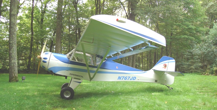

Good stuff. I will consider running it without the prop to adjust the air screw by ear without getting sliced and diced. This guy who has looked at it once claims to be experienced with two cycles. He is an aircfraft owner and pilot but his experience has been on motorcycles and such. We ran the engine after moving the needle valve from the third notch to the second. After running the engine like that and looking at the spark plugs, he felt it was running too hot, and we put it back to the third notch. I flew it today after setting the pitch for 6200RPM static. I saw about 1050 on the EGT, which I hear is about right. I would say it ran cooler with the lower pitch, but the OAT was much cooler, and I still saw 180 deg F a time or two. The cloud above me sprinkled a bit on my windshield. Naturally I thought I had sprung a leak and high-tailed it home. It is still four cycling at the lower RPMs. We had messed with the air screw before, but after reading those aforementioned web pages, I reset them to one turn out. I think it is worse now. Are they still affecting the mixture in the 4000-5000 RPM range? I have to get above 5000 to guarantee no skipping. Thanks for your insights. I attached a picture for grins.
 Filesize:  120.19 KB
 Viewed:  739 Time(s)
Jeff Dill
Model 2
akflyer
Joined: 07 May 2007
Posts: 574
Location: Soldotna AK
PostPosted: Wed Aug 22, 2007 7:23 pm    Post subject: Re: 582 engine adjustments Reply with quote
great looking bird! The midrange is what seems to be off. What jets are you running? and when you look at the jet chart, are you looking at the one with our without the air intake silencer. I have seen this happen...and the wrong jets were installed. Of course, since this is a midrange problem, you could go for the in-flight mixture adjustment and your problem should dissapear, as well as being able to richen up a tad on decent to keep the EGT's under control.

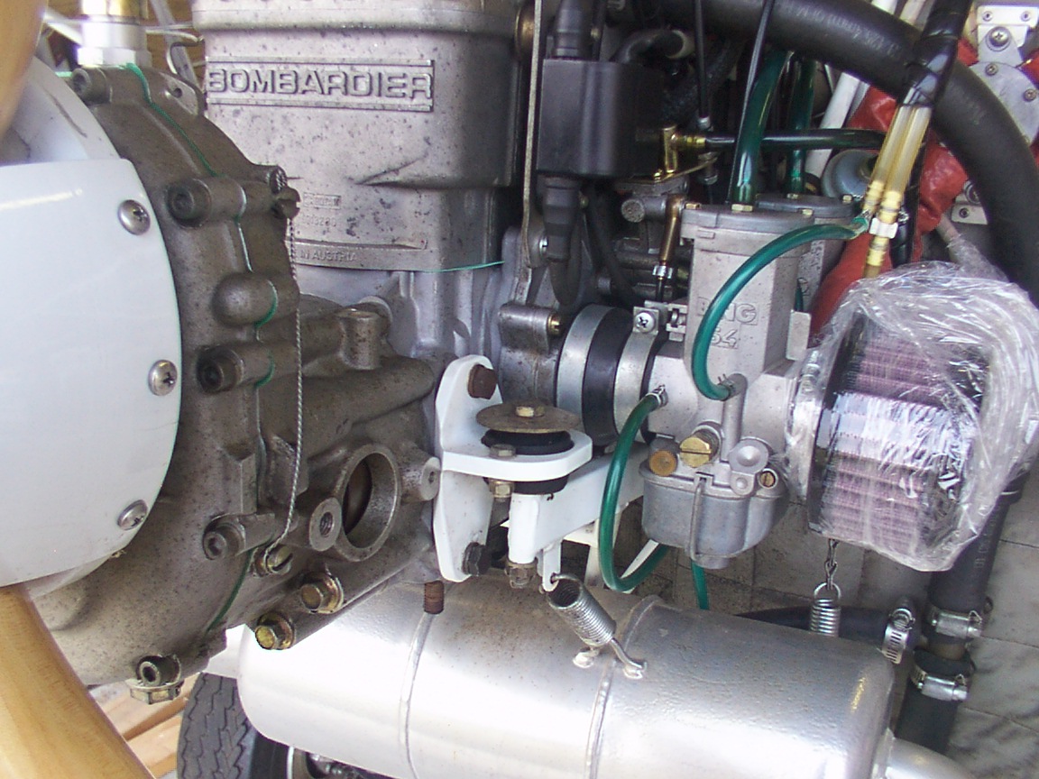

PostPosted: Fri Aug 24, 2007 6:07 am    Post subject: 582 engine adjustments Reply with quote
I've been using the HACMan from Greensky and I like it. My grey-head
had the older style carbs but it wasn't too hard to drill them to add
the ported vacuum attachment. I did add a 1/16" orifice in the static
line to increase the adjustment range. I try to keep the EGT's just
under 1100.
http://www.greenskyadventures.com/bing/HACmanFAQ.htm
http://www.dairyaire.net/hac/hac.htm
Regarding the idle, I went from the #55 idle jet to a #50 and then a #45
before I got a good idle. Turn the bleeds screws out in unison 1/2
turns at a time and test the idle again. At about 4 turns all the
adjustment is used up and you have to try the next leaner jet. I would
up raising the jet needle by 1 notch to compensate for the mid range.
Remember to mechanically sync the carbs. Easy to do. Adjust the cable
length so that the lower edges of the slides reach the top at the same
time. Then adjust the idle stops so the slides touch the bottom at the
same time. A patient helper slowly working the throttle helps. You can
hear which one touches 1st. Obviously the engine isn't running. BTW,
never run the engine w/o the prop on it; its too easy to toast the
motor, literally. Without a load the engine will run way too lean and
cook the piston and rings.

PostPosted: Fri Aug 24, 2007 6:17 am    Post subject: 582 engine adjustments Reply with quote
I meant to say I drilled one carb. You only need one vacuum source.

PostPosted: Fri Aug 24, 2007 8:37 am    Post subject: 582 engine adjustments Reply with quote
Mark,
I've got the HACMan installed too. I find that it takes alot of turns to make a few degrees difference in EGT's. How and where did you add that 1/16" orifice in static line?
Also, I've done all the idle adjustments you mentioned: swapped down to #45 jets, adjusted air screws incrementally so that slides are now practically bottomed out, but still can't get idle below 2500 rpm.
So I've got a prop clutch that is perpetually engaged at idle unless I pull out the choke. Only then will it slow down enough for clutch to disengage. I've learned to live with it but it does annoy me.
Any suggestions?

PostPosted: Fri Aug 24, 2007 11:35 am    Post subject: 582 engine adjustments Reply with quote
If you look at the picture I posted before (it's on the forums page
http://forums.matronics.com/download.php?id=6568 ) you can see the line
coming away from the fitting on the air cleaner. That is the static
pressure sense line. I bought a vacuum restrictor orifice (white
plastic and brass) from the auto parts store and put it in-line so I
wouldn't have to turn the valve so many turns to make a change. But I
found that as purchased the hole was too small and made the adjustment
too sensitive. So I just drilled the little brass hole out to 1/16" and
tried it. I also dropped my main jet from 185 down to 180 for the
summer and it seems to be about right.
About that high idle; if you have to add enrichment (choke) to make the
idle stable below 2500 then your idle may be too lean. I run my GSC
prop at a high pitch (I only see about 5900RPM static) and I know that
makes the engine run rich. BTW, that is a good test. At any throttle
setting but full the enrichment lever will add gas through the idle
circuit. So if you add fuel and the EGT's fall sharply and the engine
stumbles then you could try a little leaner assuming that the EGT's
don't go too high. Also note that the midrange jet needle and needle
jet affect the idle. You could try raising your needle one notch and
see if that helps.
Cheers,
Mark Napier
N246DR
