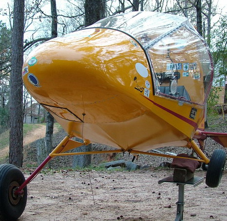

Pattrick:I put mine under the nose.Photo attached.john hmkIII

When I put the antenna on mine, I had the advice of an FAA technician whom I worked with. Simply, as far as possible from other metal objects that protrude from the surface, and with a metal ground plane. So I slid a sheet of thin aluminum to lay between the boom tube and the side tube, on the lower fabric in the aft part of the cage behind the cross tube that goes between the landing gear. The antenna is mounted in the middle of the ground plane, and turns back to parallel the boom. Works quite well. Picture here -
