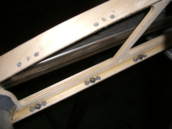

PostPosted: Sun Aug 12, 2007 8:24 pm    Post subject: Re: Was rivnuts now nutplates Reply with quote
I came across this handiwork and liked it enough to save it. I believe it was a Just Highlander builder, sorry, no name.
 Filesize:  116.1 KB
 Viewed:  457 Time(s)
