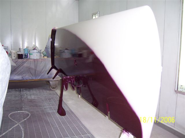

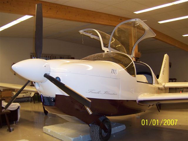

PostPosted: Fri Jul 20, 2007 12:28 am    Post subject: Europa colours Reply with quote
Rob,
I am not going to encourage anybody to paint their
Europa´s undersides any colour but white. I still well
remember Manual´s words: all the Europas must be white.
I still have to point out the energy of the sun is NOT
reflecting out of the black asphalt IMHO. That is why
it is hot when a sunny day. It absorbs allmost all the heat
energy and nothing is reflecting out. White surfaces are
cool because they are reflecting out much more.
So it could be more dangerous to keep it on the snow covered
surface while a sunny day (or on white sand or water w Europa floats!).
In Sweden there has been 10 years a wonderful full colour mid red Lancair 320
and no composite problems at all. Register # is SE-XOP (!). And like
we all know in South America (Columbia?) there is flying a total deep yellow Europa.
I think - with other colour as white - it is better to be even more careful.
Beauty is a good reason for some extra work and some sacrifice.
That is the fact all the women know. That is all.
"Keep your full matt black Europa in the hangar and fly only night time if you wanna be absolutely sure"
Raimo

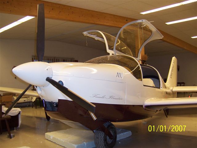

raimo.toivio(at)rwm.fi
PostPosted: Tue Jul 31, 2007 8:56 am    Post subject: Europa colours Reply with quote
Dear Jim,
as I have stated earlier
painting dark (underside only)
is only my decision and it is valid
here in Scandinavian, quite near
Polar Circle. When not in airborne,
it is in hangar - not under the sun.
I wish pure white colour makes you happy
in every climate in every temperature.
It must be like a prayer - with it you can
do what ever you like - w/o own judgement.
I have a headache - you have kicked my
head to the hot asshole.
Raimo, still the beauty is first of all
attached a pic of my "dark & dangerous" Europa
 Filesize:  60.11 KB
 Viewed:  285 Time(s)
gregoryf.flyboy(at)comcas
PostPosted: Tue Jul 31, 2007 10:51 am    Post subject: Europa colours Reply with quote
Raimo,
That sure is a beautiful looking bird, you must be proud. Up there near the polar circle, you might need that darkness to keep the belly from getting too cold!
Greg
From: owner-europa-list-server(at)matronics.com [mailto:owner-europa-list-server(at)matronics.com] On Behalf Of Raimo Toivio
Sent: Tuesday, July 31, 2007 10:03 AM
Subject: Re: Europa colours
Dear Jim,
